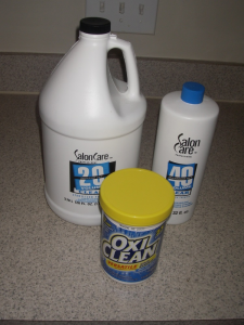

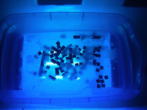

I decided to go with a liquid approach instead of paste/gel. H2O2 is relatively cheap and the case is thin, so submerging it in liquid shouldn't be too difficult. I went to Sally and picked up some developer for about $10. I already had some oxy clean at home. I got a gallon on 20 volume and a liter of 40 volume which combined yield about a 7% solution, which is a little lower than recommended, but should work.
70489-0

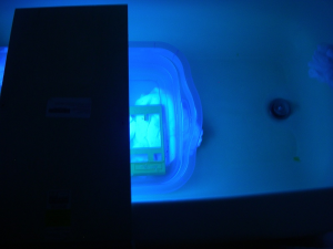

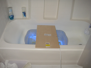

I have a UV exposure unit I built previously to expose photosensitive PCB material. I put the retr0brite in a plastic container in the bathtub ( in case of disaster ) and then placed the UV above.
70491-170493-2
The case took about 5 hours. When it was finished, I put the key caps in the remaining solution. The keycaps sink when turned over. I placed the container on some boxes and put the underneath.
70495-3
The key caps to much longer, but the solution had probably lost strength due to the breakdown of the H2O2.

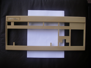

Results
The Case:

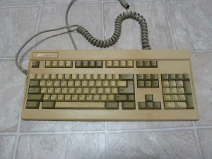

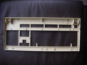

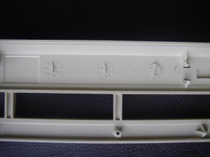

Here are some photos of the case before. The inside color is probably the original color. Note the build markings with a date of 87-09-23. Who knew Borg Warner made keyboard cases?
70497-470499-570501-6

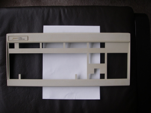

After
70503-7
Its still slightly yellowed, but close to original.

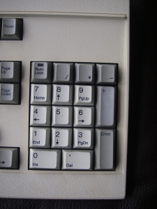

The Key Caps
Before
70505-8
After
70507-9

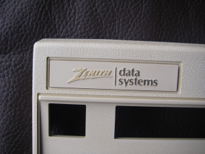

The Zenith logo on the dip switch cover was silver originally. The Retr0Brite removed the silver color. I can paint it back. Curiously, the silver on the "data systems" remained.
70509-10
The white key caps still show some yellowing, while some of the grey key caps suffer from some white bloom; noteably the "+" key on the numpad.
70511-11

Really impressive! I have some boards and keycaps that could really use this treatment... just a matter of tracking down the right chemicals.
I got the peroxide from Sally Beauty supplies. They have stores just about everywhere.
