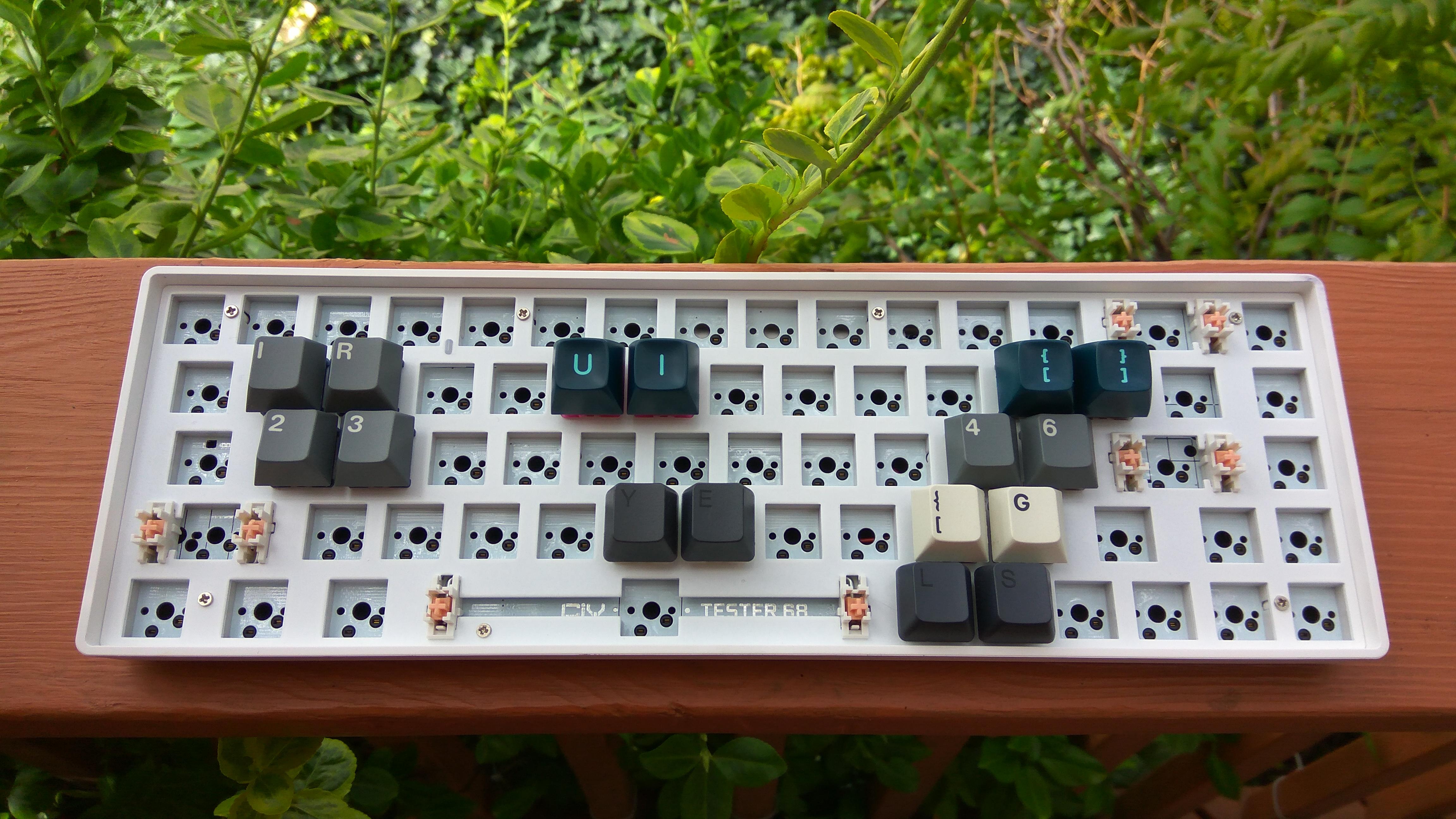

You probably shouldn't purchase a board just to see what the switches are like. That might have made sense back in 2010. But today, if you are getting into this, you're going to get in somewhat deep. So it's sensible to just buy a switch-tester and/or a cheap hotswap keyboard (that you can sell later), and just consider them expenses for finding the best keyboard.
You use a cheap hotswap to find the right switch - you can put anything in there: MX Blue, MX Red, MX Silent Black, whatever. And much more exotic things. Then, you can get a custom kit or have a factory board [like your Ducky] retrofitted.
I hope that the Ducky board works out and is the best fit for you. It's a great board, usually, and the silent Blacks should be noticeably quieter than MX Brown.
If it doesn't work out, then it may be time to test other switches in hotswap. There's likely a switch out there for you, you just don't know it yet.

Speaking of switch tester / hotswap keyboard, incredibly, there are still Tester68 in stock:
https://www.keebmonkey.com/collections/recommendations/products/keebmonkey-x-ambit-kb68-budget-keyboard-kit
Probably won't be cheaper ever again in North America. It costs ~37 USD to get one shipped to Canada. Works fine:

I did some more blind tests with some different springs (45,55,65, long 3-stage, stock banana) and in the end the winner was stock banana, with 55 (so-called "long" springs - I think 16mm, which is not nearly as long as the stock banana springs) a close second.
Thanks for the details. I will try a Silent Sky Banana with a stock spring, once I get more. The 55 G 15mm Spirit is a bit weak for these, I think. The tactility of the Banana housings is greater than the TTC Gold Brown V2s that I use for Silent Skies.
It probably also depends on your keycaps. I tried them with 45g springs (not sure what length, either 15mm or 16mm) and they were just fine. They felt good and were responsive enough, though just a little less typo-proof than I'd like. I use signature plastics DSA though. They are nice and thick and solid feeling, but still probably have less mass than a taller keycap like OEM.
