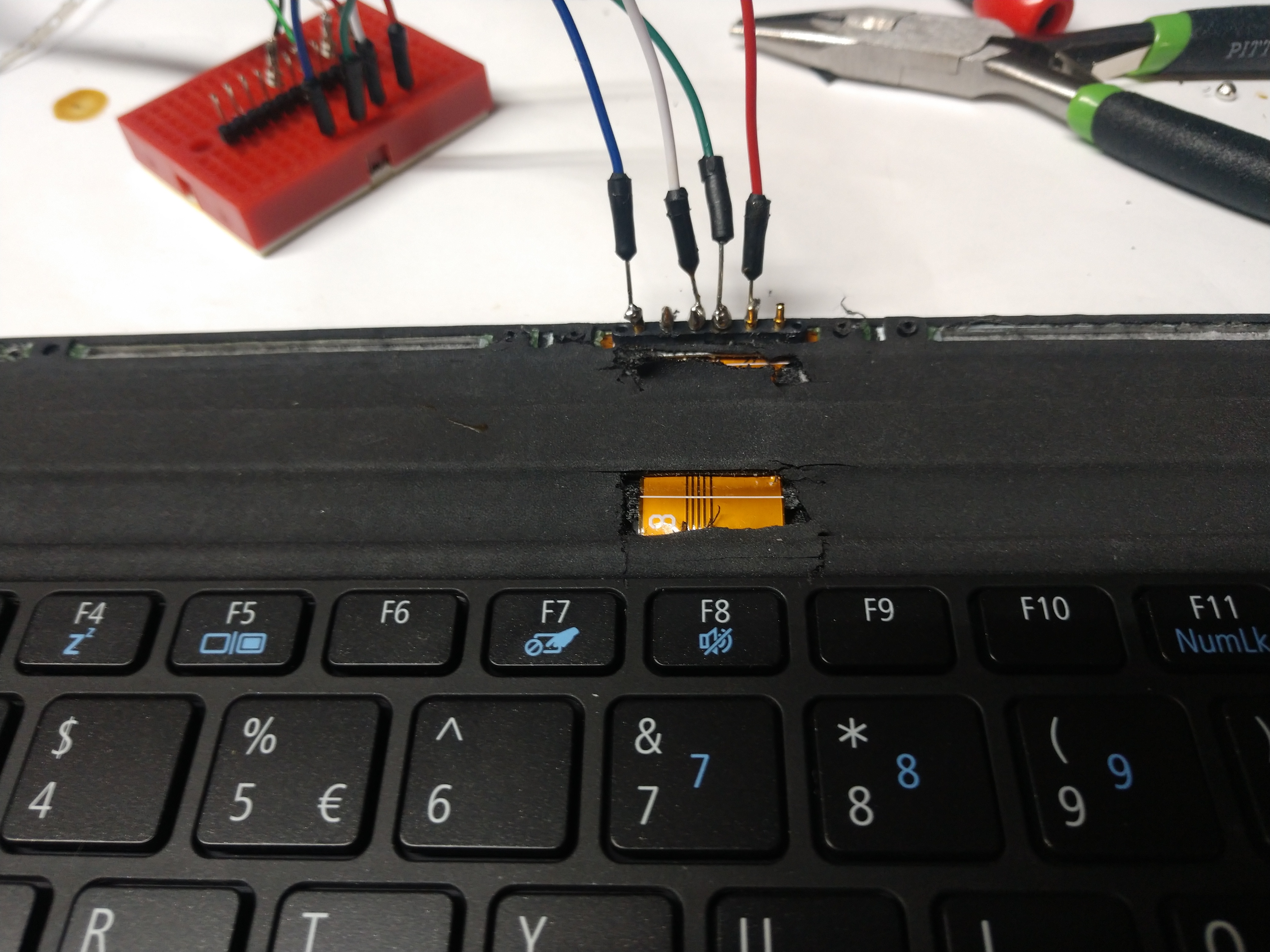

Just thought I would post this hack I figured out.
I happened to come across a large supply of Acer switch detachable keyboards. SW312-31 N17H1.  It's a nice action small keyboard and I wanted to use it on a kitchen computer setup because its so small.  However it has no USB connector just 6 gold pins with no markings. like this:
                                pins
                           1   2   3  4  5  6
   |               Q  W  E  R  T  Y  U  I  O  P           |
   |____________|SPACE BAR|_____________|
                          |TOUCH PAD  |
                          |__________ |
               Pin# 1 Ground Black wire of USB
                   # 2 Nothing  (not used) (no connection)
                    #3 White wire of USB    , Data -
                    #4 Green wire of USB   , Data +
                    #5 Red wire of USB  +5V
                    #6 No connection (not used)
  240694-0" alt="" class="bbc_img" />

I have been noticing the keyboard connection drops out after a while.  I unplug and replug and it works again.  Does anybody have an idea this might happen?  should I connect the unused pins to ground?  and by ground I mean either the Black ground or the shielding of the usb cable.  Any suggestions?
