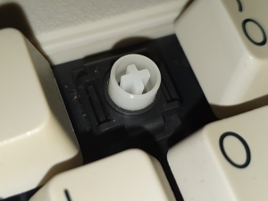

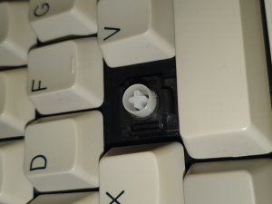

Detailed Pictures of the "good" switch (C key)
230503-0
230505-1
230507-2

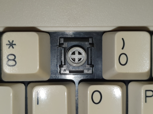

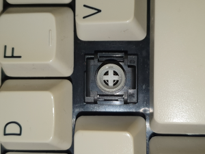

Detailed Pictures of a "scratchy" and binding switch (9 key)
230509-3
230511-4
From the above pictures, I can see now that the "good" switch, has some kind of lube applied to it, you can see that in the bottom of stem, whereas the "bad" switch seems to have no lube. That's weird. Did it came pre-lubed from the factory, or did someone lubed that particular key and didn't lube the others? Does this mean that I should lube all of them maybe?
