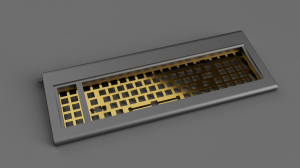

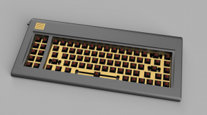

The initial design was derived from the Model F XT, and is basically a mechanical version of it. The curve was created by a difference in the angle of the case and the angle of the plate -- a nice solution I found without making the PCB actually curved. The keyboard hides away 1mm of the keycaps in the front and 4 mm at the end. I found this design unnecessarily bulky, plus the nearly-96-layout isn't that practical after all. So after some feedbacks I decided to shorten it down to a 65%, while still keeping the two rows on the left.
224262-1

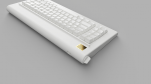

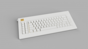

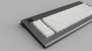

and here it is! I've also tried putting on some keycaps to see if hiding 4mm at the end is too much, but it turns out to be just right for SA keycaps. Below are some extra renders with keycaps on:
224264-2
224266-3
224268-4

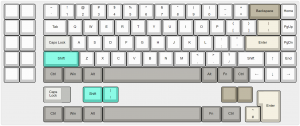

65% key layout with extra functions on the left

I'd definitely be interested. How would it look with GMK keycaps?
Offline RockZ
  • Posts: 8
Re: Comments/suggestions for the modernized Model F?
« Reply #4 on: Tue, 13 August 2019, 10:19:47 »
More renders on that coming up soon! I've been designing this to fit spherical caps, but cherry profile definitely needs attention too.

At first that sounded like my dream coming true .... - until "I decided to shorten it down to a 65%".
That 65% + F-keys already exists, why do it again?
The full "Model F XT" layout on the other hand would have been unique for a modern keyboard.

Looks great. I like the faithful placement of the cable port, the grated ibm-look block badge and use of the original ear as a rotary encoder. Personally, I think your original design with the numpad looks better and more unique, but I doubt many people share that opinion (I'm partial to big, vintage boards). Other than that, I can't find much wrong with this!
Well judging from replies to this post so far most people clearly liked the larger one better! However the larger version will be more than 450 mm in length and will be a bulky buy on the desk -- it will be more expensive as well, while this could be done below 300$, the other larger one can hardly be.
The other interesting fact is that when I sent the first post back in China, people favored the small one a lot more. I guess I'll just take more opinions and see what you guys think!

The all white version looks fantastic! I would definitely be interested, and I love the form factor/size. Having those extra keys on the left side, as well as the rotary encoder, is genius. All of my boards are 60-65% because I can't stand having to put my trackpad/mouse too far to the right. But I would welcome some extra keys on the left side.
Hot swap, USB-C and QMK, perfect.
But what about bluetooth? I would definitely pay extra for a wireless version.
Good luck and I hope you make this happen! I would definitely be on board as long as the price stays under $300.
