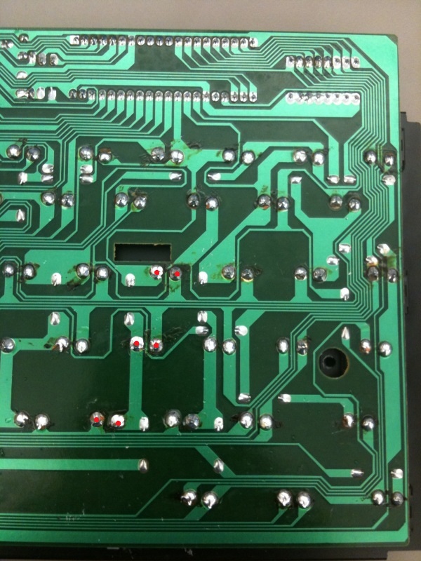

I just did a full switch swap of Dampened ALPS from an AEKII into a Geek Hack Space Saver (SIIG Minitouch) so I could use it at work where you can hear a pin drop and they are tiring of my very loud clicks and shenanigans.
Did the full swap and all but 3 keys work.  E, D, C are dead.  Replaced all 3 switches, still dead.
2 share 1 common land, the other does not.
Any suggestions?
Yeah, I know I have some flux to cleanup and some soldering could be prettier.

I suspect there is a bridge on the other side of the PCB where I've drawn a dotted red line here:
That would put all 3 switches in the same line, and there might be a break where I've drawn the circle.
I don't think there is static damage to the IC, or more than 3 keys would be affected.
Do you have a multimeter? Using one to check that there is an electrical connection where there should be would help isolate the problem quickly. Buy a cheap one if you have to, you don't need anything fancy, just one that measures resistance.

I had done a full switch swap, I didn't swap any of the ALPS internals.
Raj, you were dead on, there is a bridge where you thougth there was and there was a break exactly where you thought there was.  The break was just below the circled terminal and must have happened when i was removing a switch that still had some solder on a terminal that pulled part of the trace from the edge of the hole.  At first I was going to do a very short repair so I scraped some of the trace to do that but decided to add a wire going to another terminal and it's working perfectly.  In fact, I'm typing on it now.

How I fix a trace:
1. Scrape the coating off the trace to get to bare copper
2. Use a short piece of wire to bridge the gap and solder in place.
3. Coat the area with Nail polish (I usually use clear)

« Reply #5 on: Wed, 09 June 2010, 18:41:05 »
Yeah that can happen with minitouches cause the pcb's aren't very robust, so careful with that. Glad you got it solved.
