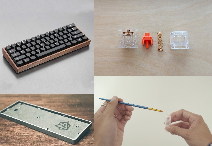

237967-0" alt="" class="bbc_img" />
Hey guys, I'm looking to build a keyboard soon that will hopefully be much quieter than my current Corsair Keyboard with Cherry Blues. I have a daughter that is 2 months old that will be sleeping in my office while I work from home. I have ventured into the idea of building a custom keyboard, and a top consideration is how to make sure the keyboard is silent (or at least MUCH more quiet than my current keyboard.)
Above are the 4 ways I have learned to ensure that my keyboard is silent/quiet: wooden/acrylic cases to absorb sound, silent switches (Healios pictured above), foam inserts for the case, and lubing the switches and stabilizers. Any other considerations would be helpful to further ensure a nice quiet KB.
For my build, I'm considering the following:
65% PCB (not sure which one to buy, advice appreciated)
Wooden Case
Healios or Tangerine switches

Two more questions: does the mounting plate for the switches affect the sound that much, and does the overall weight of the keyboard affect the sound?

I hate to say it, but your best option for silent switches might just be a rubber dome.

I agree.  Personally, I'd go with a scissor switch keyboard or a silenced Topre if it was going to be in the same room as a sleeping baby.  I think my wife would have killed me if I had suggested putting a computer with a mechanical keyboard in the same room as either of my kids. :)  I currently have two keyboards with Cherry MX silent black switches: a Cherry G80-3494 and a DasKeyboard 4 that I customized.  The stabilizers are the loudest part of either of them.  One's a hollow cheap plastic keyboard with PCB-mounted switches and the other is a very solid plastic and metal one with a steel plate, but the stabilizers are by far the thing that makes the most difference in the noise level.

I dunno...Silent MX can be pretty quiet...Still, I don't see how you work in a home office without making noise whether that be the mouse or keyboard (any keyboard).  How do you do a conference call?
Maybe build a silent box in the room?

Even R2 silenced Topre is much louder than a scissor switch; there are plenty of nice (and very cheap) scissor switch keyboards you can buy at local stores. There's no reason to use a mechanical keyboard when silence is number one.

Idk bruh my Silent black MX build lubed with 3204 is more silent then all the rubberdomes at my workplace.

Buy mx silent black switch, swap springs to the weight you like, lube those switch and stabs  :thumb:

I've come to realize Realforce stock silent is quite bad (I bought a R2 Silent model), the best silent is if you mod Topre yourself.
I would say get a regular R2 Realforce and then get DESKeys silence rings #3 is the most recommended standard in terms of tactility vs silence, so if you want it to be even quieter I would say go with #4 or #5.
Although if you do everything you listed you should be ok with Cherry style switches too I think.

I dunno. Zilents are pretty flipping quiet.
