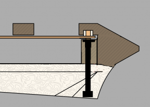

After working through some assembly connections for the case, I tweaked the base and profile some.
Been working towards a gasket mount for the case, and will follow up with some imagery once I figure out the best was to share the assembly and intent.
Love to hear thoughts.
249624-0
249626-1

Assembly image.
249650-0
Gasket mount design.  The mid portion of the case is dovetailed to combat any sheer on the top.  This is fastened directly to the top case, suspending the plate on rubber strips.  The cutouts along the border of the plate assist with alignment, allowing you to rest the plate on the rubber strips in the top case during assembly.  Mid portion of the case also serves as the mounting point for the base, preventing any fasteners being shown on the outer bevel of the design.
Appreciate any feedback on the intent.  Any blaring flaws jump out?

Offline Leslieann
  • Posts: 4574
Re: mnml83 - WIP Design Log
« Reply #23 on: Mon, 17 August 2020, 00:47:26 »
The dovetail to combat sheer...
There's nothing that will do that the bolts and clamping pressure won't. It's more likely to dent or bust off the dovetail than do much of anything. Besides where is it going to go, the only time it would ever have a sheer force is when tipped on it's side. It just adds complexity and cost, each cut adds to the price.
As for alignment, again, trust the screws. It's nice in theory, but if anything is off in the slightest, you have no room to adjust and with this having wood and needing to be down to fractions of a mm, you might need that slight bit of wiggle.
Gasket mount..
It's being compressed by wood, it may be hard or soft wood, but a bit redundant unless you run the screws loose (that's not the purpose of gasket mount). Wood has very different harmonics than metal and all of this is based on ideas we use for metal. Depending on material, the gasket could also suck moisture from or leach into the wood and since it's inconsistent around the perimeter this could lead to issues later. I assume silicone or rubber, but not all silicone and rubber is created equal. And have you given thought to where these are coming from?
Then there is the actual clamping, unequal clamping force will lead to warping the wood making it impossible to balance out again later. You're better off tightly clamping this whole thing together using a torque wrench and head bolt pattern to do so.
The Marble,
You cannot simply mill it into any shape you like on a typical mill like aluminum, it can be done, but it's specialized. It would be FAR more efficient to use a single flat square (or as close as possible) and recess that into the wood to give it an angular look.
Just a heads up.
If you're outsourcing all of this, even if you start with Oak, I won't be surprised if you're well on your way to $1000 by the time you add modest switches and caps.  Making a few of these changes could knock a couple hundred off and reduce the risk and number of potential problems. Also, start with the marble and plate then re-adjust the wood if something is off rather than having them redone.

Offline Spor
  • Posts: 14
« Reply #24 on: Mon, 17 August 2020, 10:15:08 »
First off, A massive thank you for taking the time to form such a thorough and detailed response.  My background is design and architecture, and though I have done some rapid prototyping, this is well out of my knowledge base.  This is the exact type of critique I was hoping for.  I knew this was ambitious, so I appreciate the thoughts on feasibility.
In hindsight, I believe sheer is 100% the wrong term.  I was hoping to combat "splay" (unsure if there is a more accurate force description).  But perhaps I can walk through the logic to see if there is any validity.
Primary goal was to prevent any fasteners to be countersunk into the bezel.   (Both for the wood and base)  So my thought for this was to top mount the plate and then have a mid portion of the case in order to receive the fasteners of the base.
249723-0
In order to avoid breaking the profile of the top, my thought was to fasten the mid where the case met the plate (which is why a gasket mounting style developed, though I 100% agree with your later points).
My fear with this fastening location, though it did achieve a seamless exterior of the case, was that it may introduce rattle.  I was imagining that there was a potential for the top to splay slight as the wood "gave" with typing force.
249725-1
To your point, this could very well be an irrelevant concern.  I very much appreciate the feedback, this is just the reasoning behind the addition of the dovetail; a means to prevent that splay, while maintaining a seamless exterior.
Gasket mount..
100% agree with your point, of this most likely being a redundant unnecessary over complication.  Thank you for the input!  If the mid portion of the case was to remain attaching at the plate; would you suggest just sandwiching the plate tightly between the wood?  Or fasten the plate directly to the top?
The Marble,
And yes, I agree this is the most ambitious aspect by far.  I am in contact with a couple of manufacturers right now, some small, and some large in hopes of putting a number on this.  I will certainly look into a VE effort in the event it is prohibitively expensive.  This has certainly been a learning experience so I very much appreciate the feedback.  My goal is to perfect a prototype prior to anything else.
Again, I really appreciate your thoughts, and would love to continue the dialogue.

« Reply #25 on: Mon, 17 August 2020, 23:56:25 »
You're welcome.
Keep in mind, I'm being overly critical, this can work as you had it. I'm sure a few are going, "wow that's overkill", it is, but I prefer to look at it from a best case/long term perspective.
You have a brass plate and a marble plate, in a wood case and neither is being used structurally. You built your whole case to be supported by the thinnest bit of wood in the case using glued in inserts. It's backwards.
First off..
Bolt the top to the plate, use brass inserts, small screws or simply epoxy it. I would recommend lots of small screws. Yes, this makes the top decorative (as most are), but also less likely to warp.  Splay shouldn't be an issue, the wood isn't under any stress besides holding itself in place.
Second,
Tap threads into the plate, epoxy some nuts, use nutserts or use Chicago bolts, one way or another bolt the plate all the way through the lower wood and through the marble. Effectively clamping the wood between each and using the heavy, strong marble as your foundation, not simply a bolt on weight. This will make for a much more solid case. This also allows for a much simpler center part as you will see.
Third
Remove the wood in the bottom, if we use the marble as a structural part, this is no longer necessary, allowing for a much lower profile base. This part can now be water jetted, lasered, jig sawed out of ABS, cast epoxy, plex, polycarb, wood, plywood, whatever. It's simply a ring with a few holes. You could even just buy a bunch of appropriately sized spacers and use those (don't do this, it's just to emphasize how little it matters).
Fourth
On the rear, that sharp edge is a disaster waiting to happen.
Instead of wedging down into the marble, I know it's to fight splay but you are counting on some seriously tight tolerances from stone and wood to make that work without bind (stressing the inserts) or having an unsightly gap.  Instead of an inward downward slope, go with a flat or outward slight down slope. You won't see any gap unless you get down below the horizon of the keyboard. If it warps it warps, your attempt to fight it with tolerances is a valiant one, but not one you will likely win. Making the changes above reduces the stress on it anyhow so it's less likely to warp in the first place.
Here's a down and dirty image to give an idea of the changes. You will have to excuse the quality and sort of figure out the top bolts but I think that part is the easiest to explain.
249785-0
