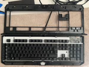

First step the Disassembly:

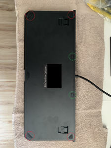

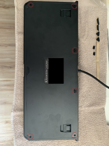

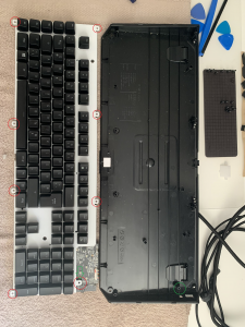

1. Remove the rubber feet (red) and the plastic caps (green).
246636-0
2. remove screws:
246638-1

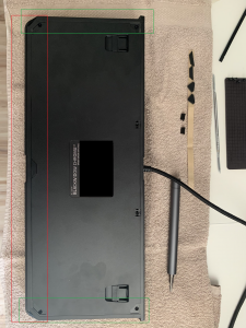

3. Remove plastic clips. Start with the Front(red) after that the Sites (green).
There is no need to unclip the Back, it will slide off.
Just be a little careful on the USB + AUX side and the Logo LED on the front.
246640-2

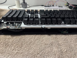

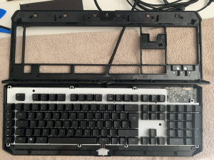

Opened:
246642-3
246644-4

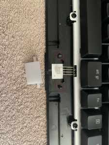

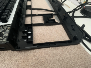

4. Remove the diffuser on top of the Logo LED. You just have to bend one pin (red) to one site and slide the diffuser off.
246646-5
5. Remove the PCB from the case. Unscrew all screws (red) and carefully lift the PCB on the site without the ports.
    Look at the green plastic location if the PCB is all the way off until lifting it out of the case.
246648-6

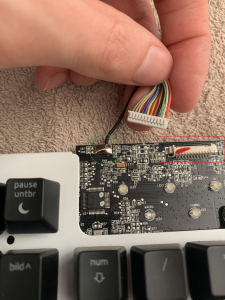

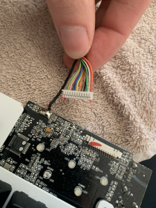

6. Disconnect the connector, these things sit tight. Pull on the sites of the jack until it comes off.
    Desolder the shield cable (green).
246650-7
You've successfully disconnected the cable! Nice!

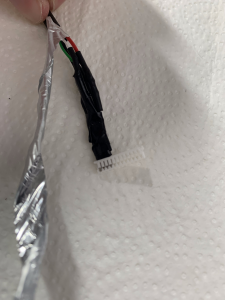

Building the cable:

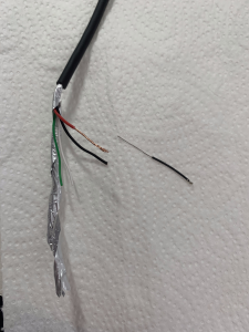

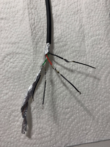

1. Strip the wire from the coat and strip the wires.
    We want to add the shield later on, so don't cut the shield.
246658-11

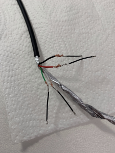

2. Attach the Molex cables with the USB wires or crimp the terminals and solder them.
246660-12
246662-13
246664-14

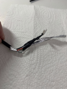

3. Isolate the wires with shrinking tube and electrical tape
246666-15
246668-16

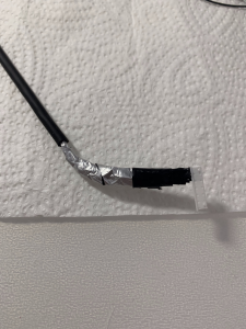

4. wrap the shield back around the wire
246670-17

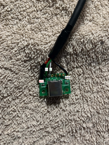

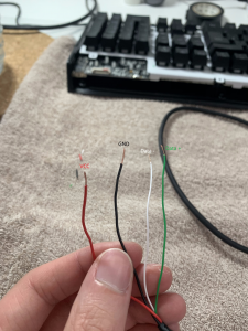

7. Solder the USB-C board - Important, switch D+ and D-
Cable Black (ground) goes to GND
Cable Green (Data +) goes to Data -
Cable White (Data -)  goes to Data +
Cable Red (VCC) goes to VCC
246672-18

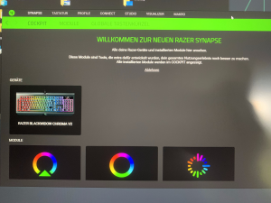

9. If there are no problems you should test if your Computer can communicate with the keyboard.
246674-19
246677-20

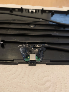

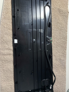

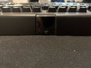

10. We are nearly finished! You just need to remove the plastic where the cable was connected and install the USB-C board.
      Check if you can still close the Keyboard and verify that the USB cable plugs all the way in.
11. Glue the Board to the case. USB-C requires force to unplug so make sure its fixed.
246681-21
12. Route the cables in the case
246679-22

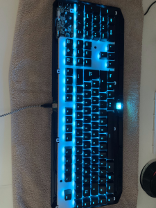

246683-23
14. Test everything again, if your computer can communicate with the Blackwidow you can assemble the Keyboard.
You are finished! Enjoy your USB-C BW!

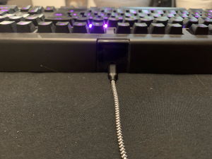

Finished Keyboard:
246685-24
246687-25
246689-26

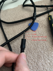

Just a quick addition, I haven't checked yet, but believe the aux it'll likely use the CTIA model. So outputs should be:
1. Left
2. Right
3. Ground
4. Mic
