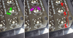

wire size.... anything will do, doesn't have to be anything substantial. use the smallest you have that you can work with.
see attached pic. check continuity between these first. all the green should be the same and all the purple/pink should be the same.  if everything is good there, check the red, you can see the trace on the board connecting the other end of the diode to the column.
- if it's something in the green is broken, run a jumper between the green pins.
- if it's something in the purple is broken, run a jumper between the purple pins.
- if it's something in the red is broken, run a jumper between the red pins.
249059-0

what i was saying was
- any of the pads within the green line should all be the same and should ring/sound when you test between any pads within the green line.
   - could jump between two pads in the green outline say if you lifted a pad or broke a trace when removing a switch
- any of the pads within the pink/purple line should all be the same and should ring/sound when you test between any pads within the pink/purple line.
   - could jump between two pads in the pink/purple outline say if you lifted a pad or broke a trace when removing a switch
- any of the pads within the redline should all be the same and should ring/sound when you test between any pads within the red line.
   - could jump between two pads in the red outline say if the column trace is broken.
249241-0
if you didn't lift a pad, and the break is further away from the switch legs, it might be within the red outline (column) or it might be and is more probable that it's in the row trace, since it's the last switch in the row. i can't see the row traces because they are actually on the other side of the pcb and i can't see the switches to the left because they are not included in the photos you provided. i tried to look at other pics online but i didn't find one with the date that's on your board or they were white pcbs and hard to see the traces.

I tested all of the highlighted locations with a continuity test on a multimeter and they all checked out just fine. Nothing wrong at all..

Either the green or pink section needs to connect to the bottom of the diode, the figure 8 of pads below the S in the SW2:13 label (I'm tired and can't work out which!) and the other end of the diode needs to be connected to the red section.  Looks like there could be pad damage on the red end from removing a through hole diode...
