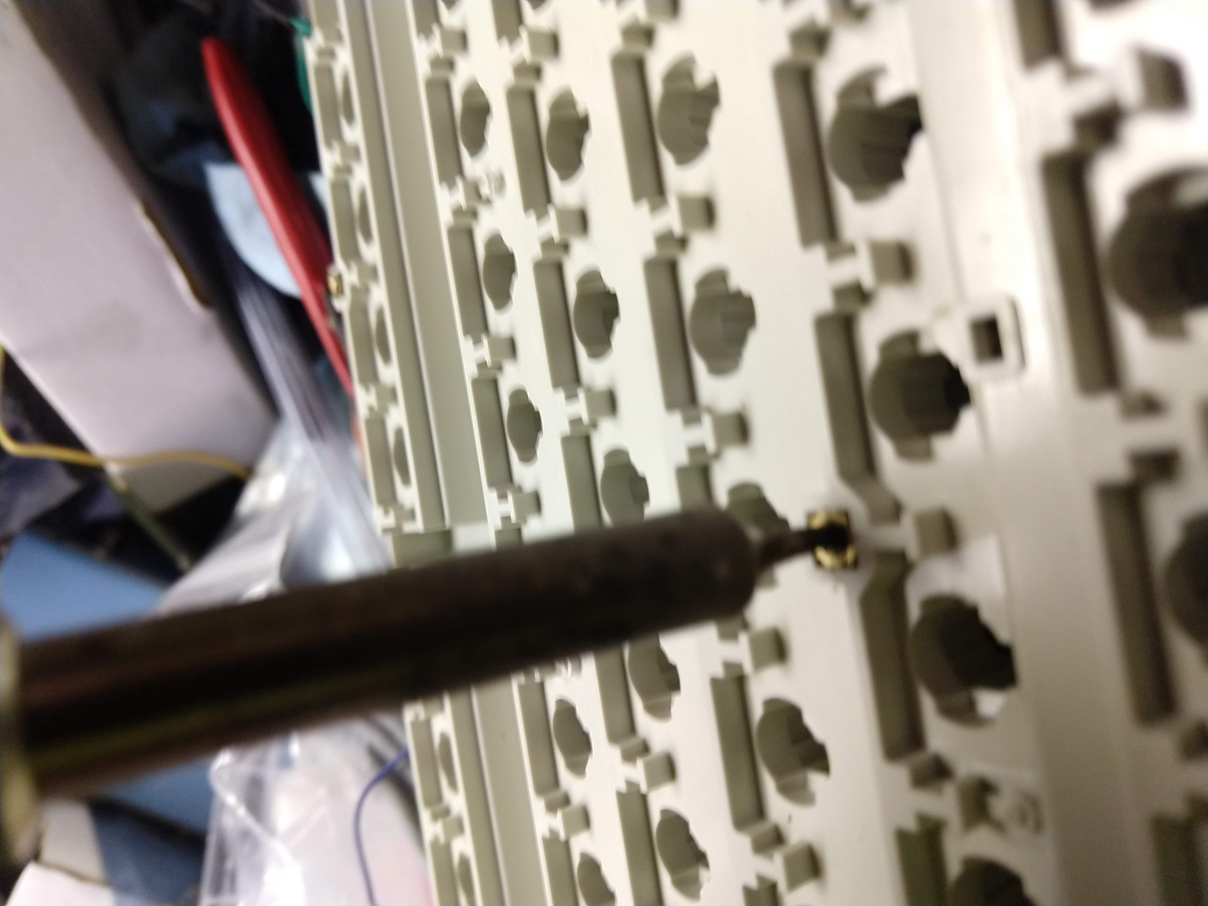

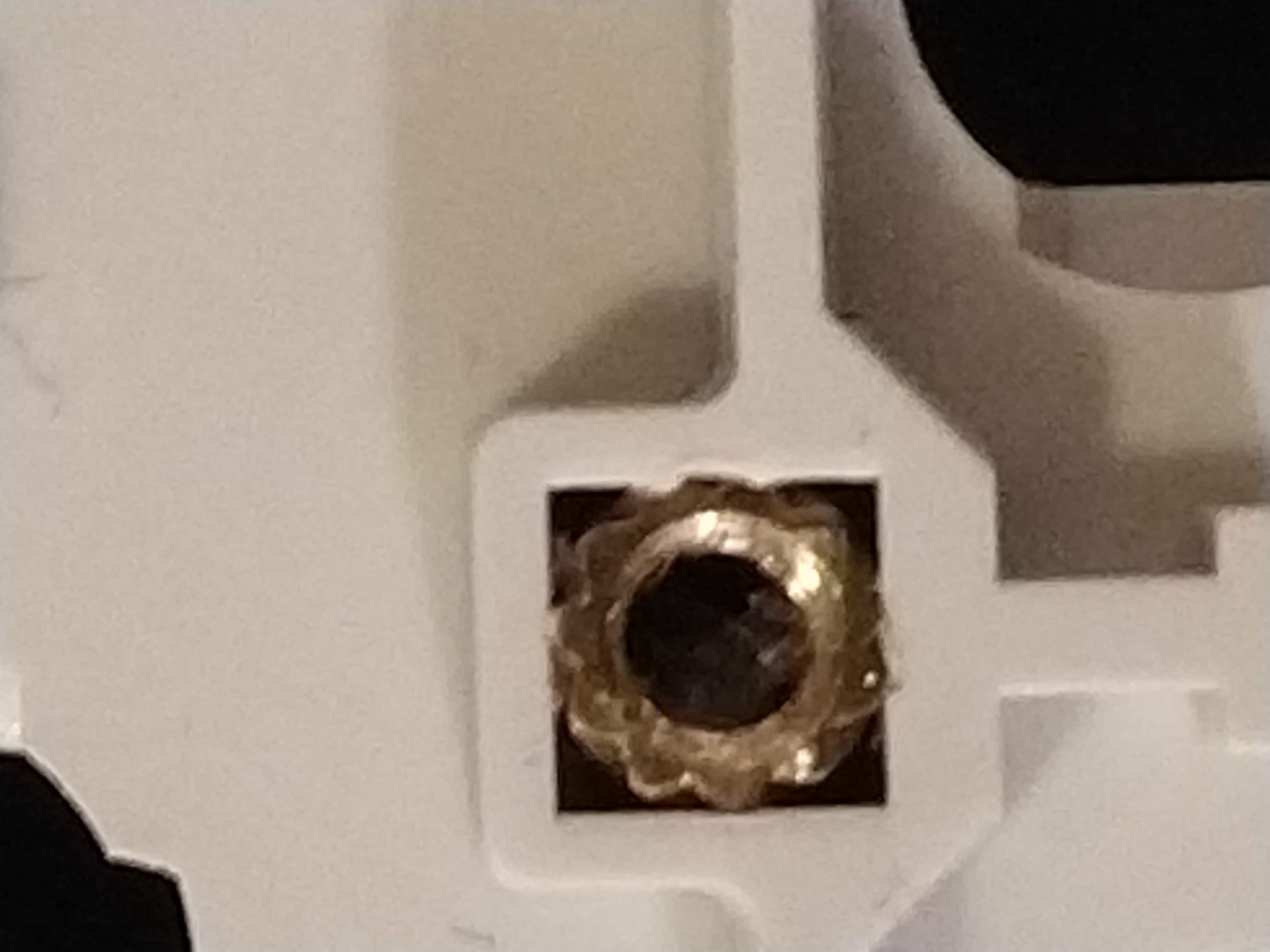

The first step involves melting the inserts into the clip pockets. This is fairly simple. I just used a 600F soldering iron and slowly melted them into the plastic. The inserts I ended up using are about 4.6mm in diameter. A slightly bigger insert would probably be better

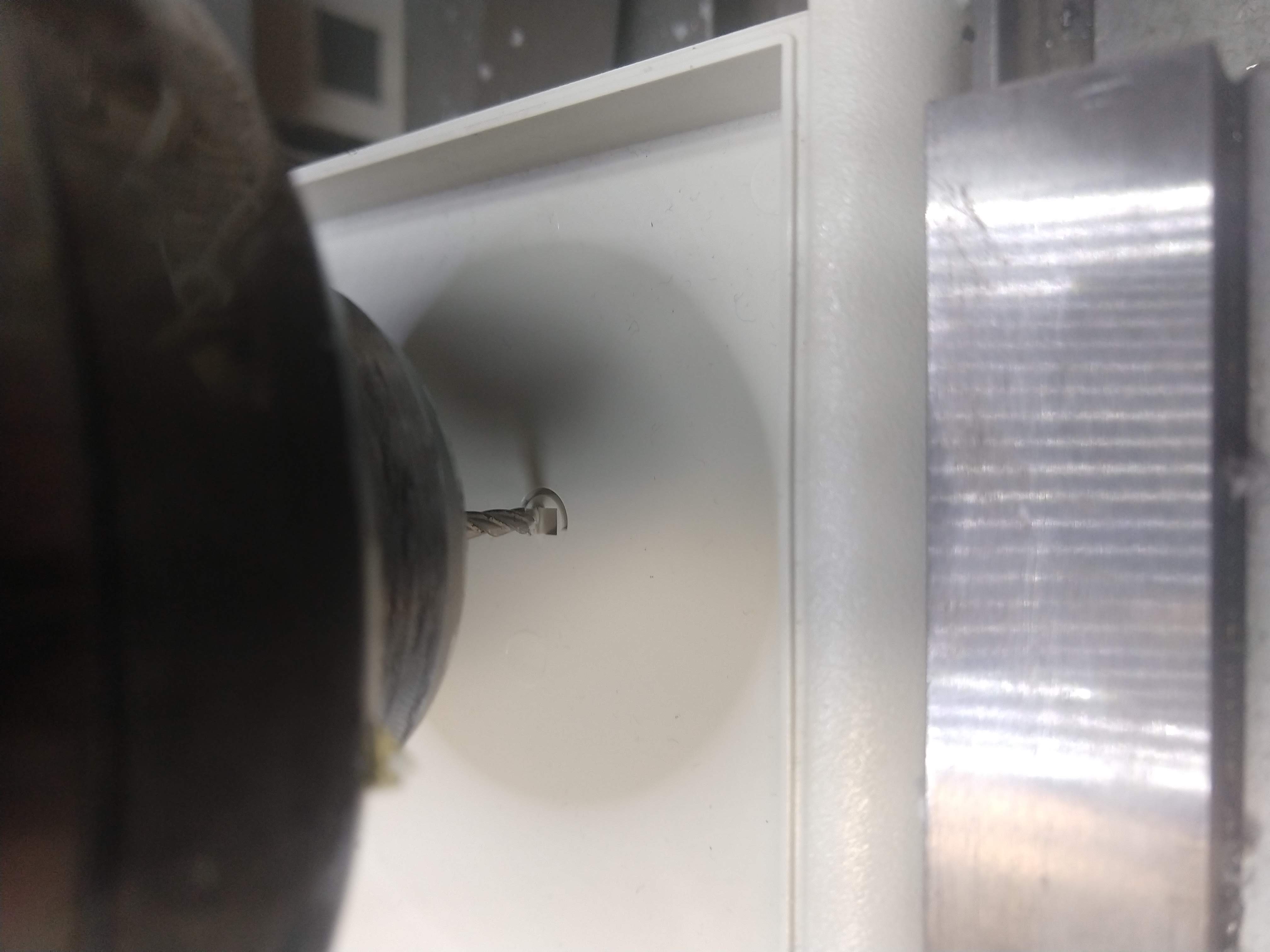

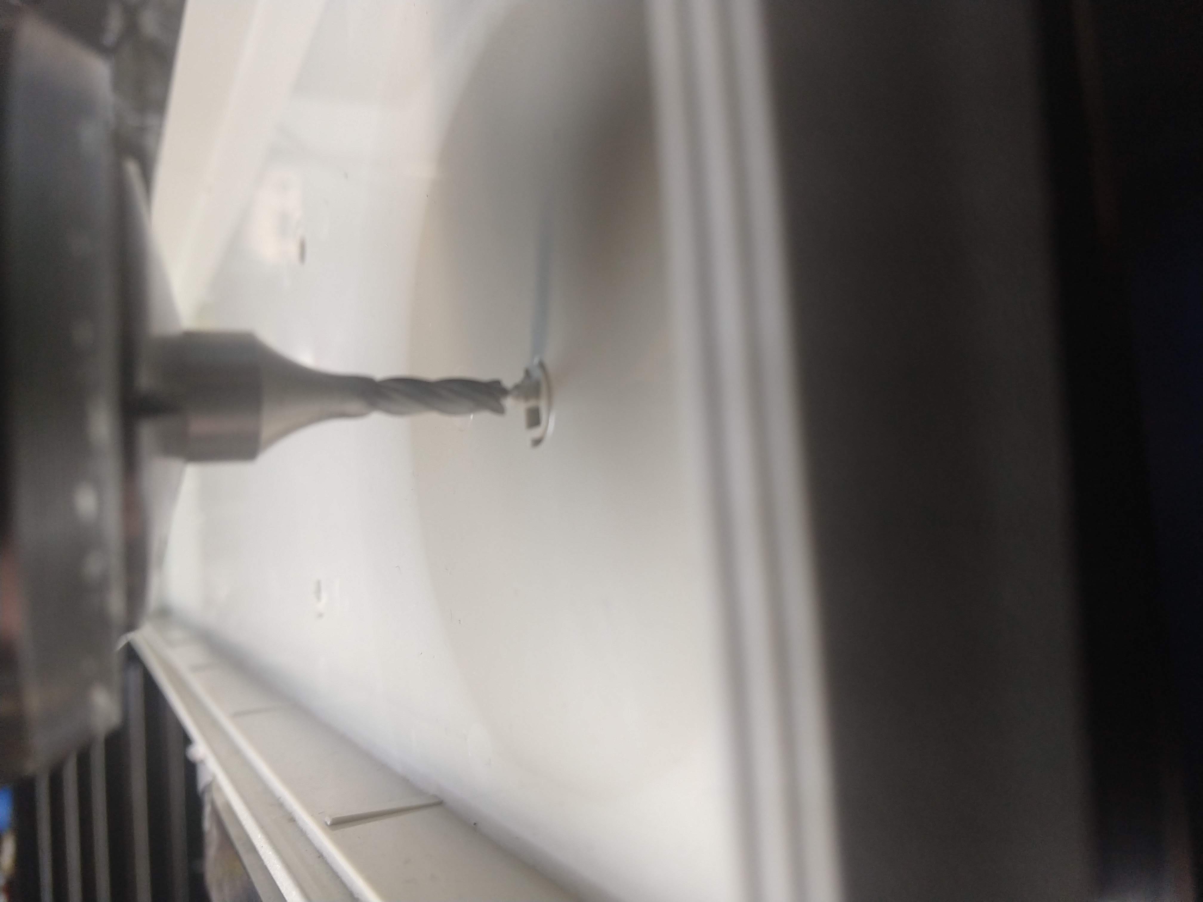

After the insert were in, I broke off the clips and then used a 3.2mm (1/8") endmill to put a hole in the lower part of the case at each clip location. I probably should have used a 4mm, but I didn't have one on hand. I ended up centering the endmill over the edge of the stub of the clip. This pretty much puts you on center with the square pocket in the top part.

I am not sure a drill would work for this operation, since the remaining part of the clip and the little rectangular cutout from the mold will probably make the drill walk too much. This makes this a bit of an advanced operation.

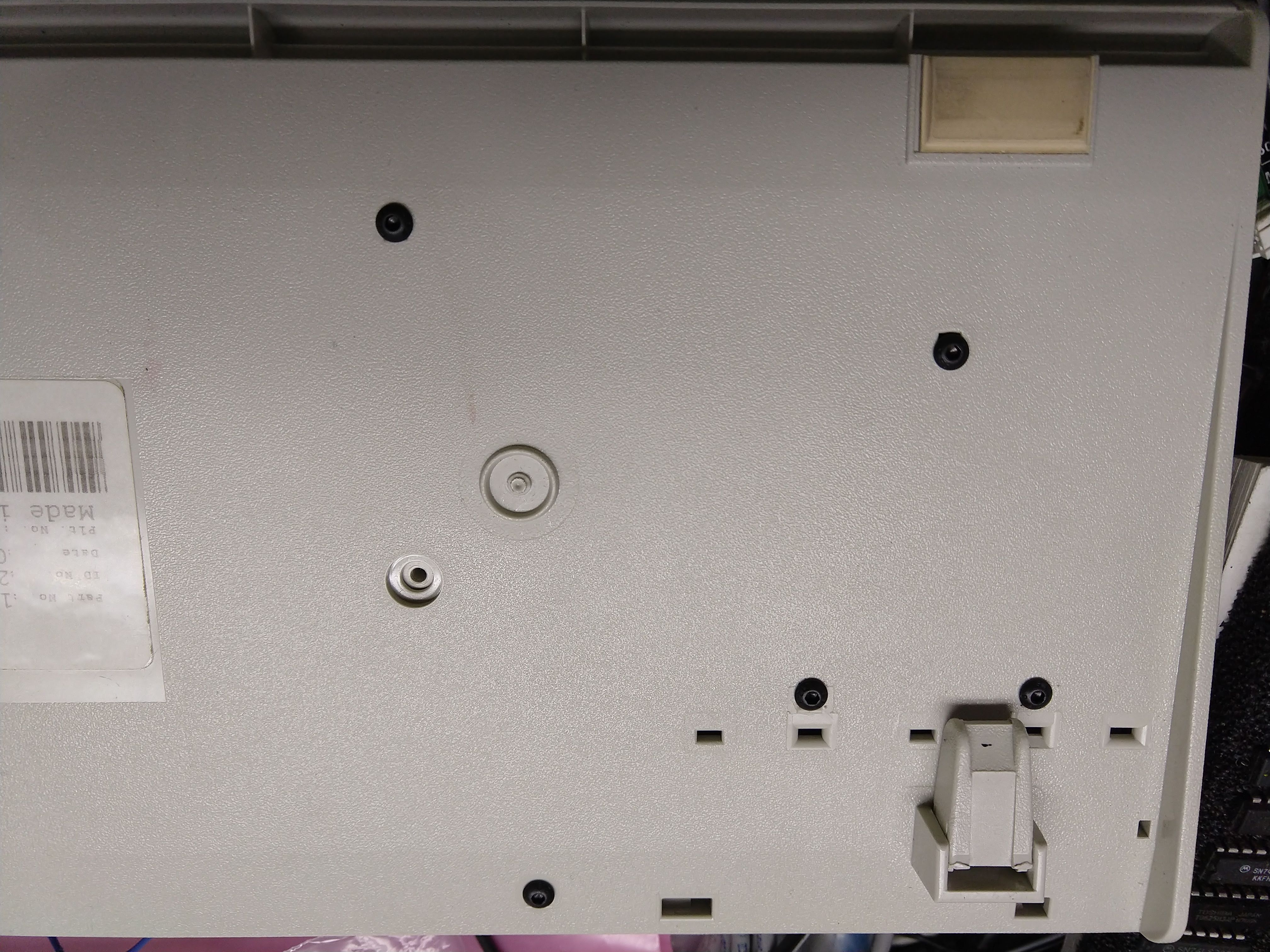

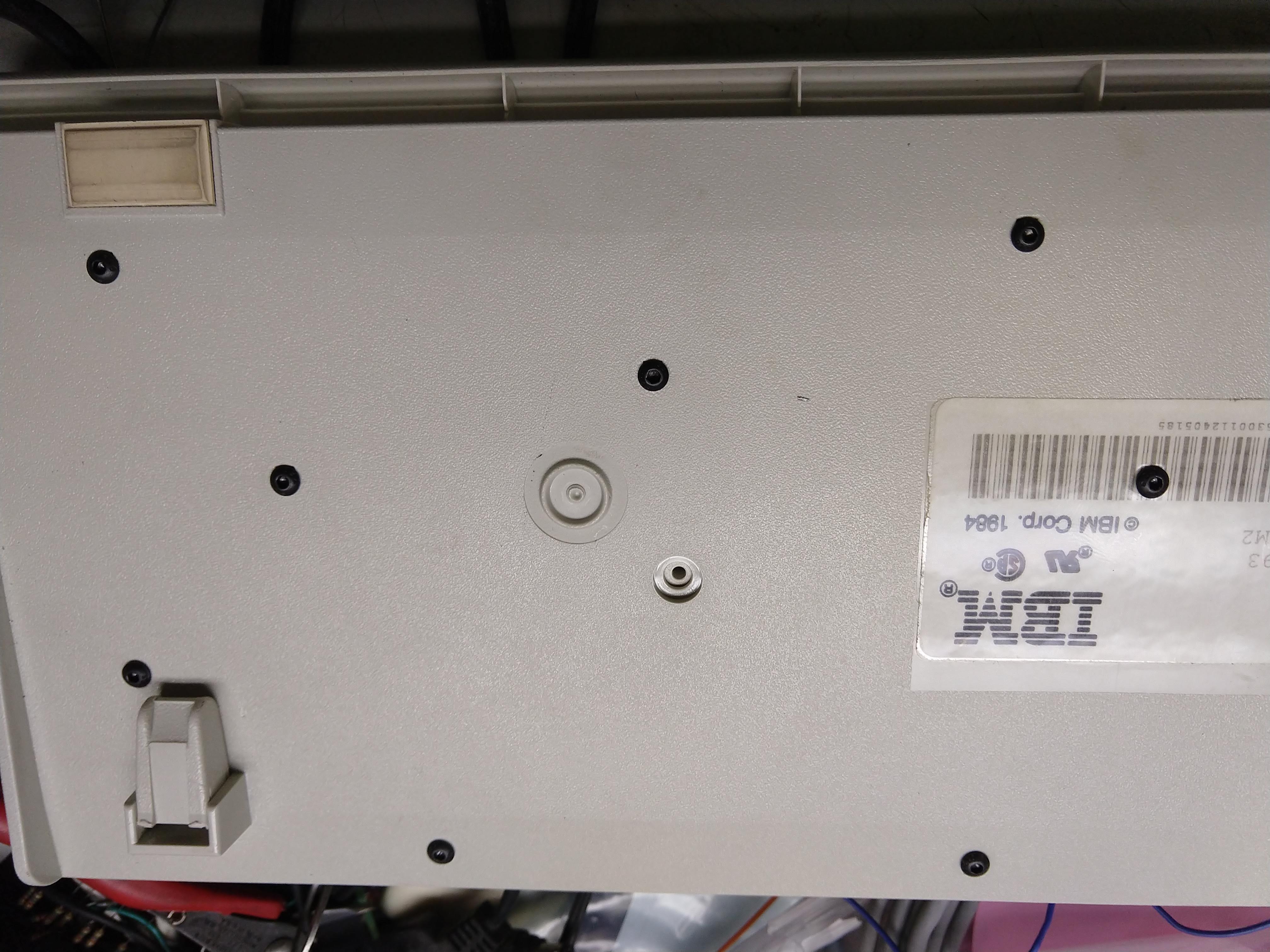

After that, I just screwed the two halves together using some 8mm long button head screws. I used those to get the full diameter head with a low profile to minimize interference.
247099-4" alt="" class="bbc_img" />
247101-5" alt="" class="bbc_img" />
Unfortunately, one of the screw holes ends up going right through the center of the label.
There is still a fair bit of flex in the case, probably similar to a generic OEM rubber dome. However, there is no appreciable squeak.
