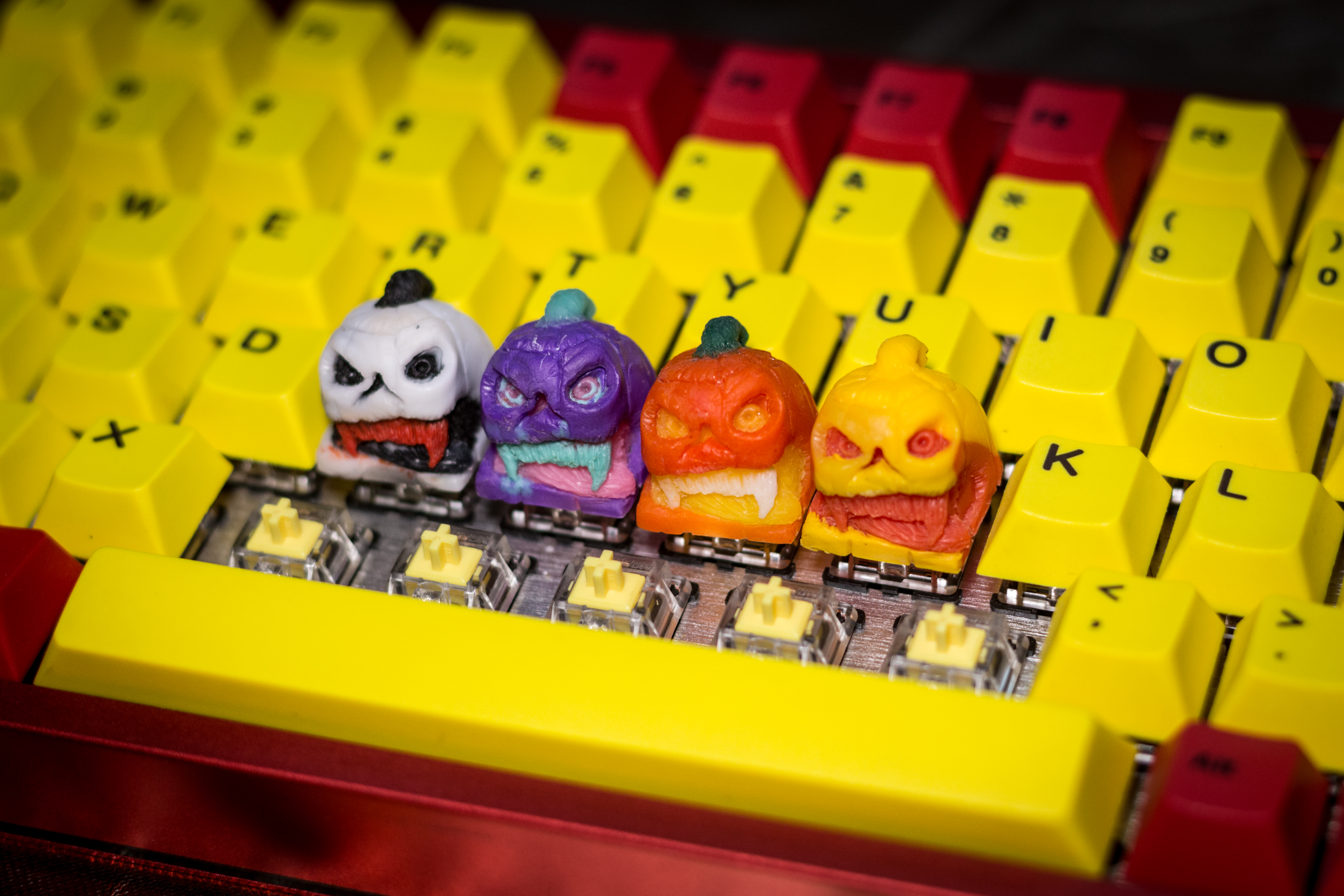

  After a few years of self taught DIY, from hobby to hobby and various shenanigans and my latest landing was artisan keycap making, this is my theory on how dyes molecularly affect the microstructure of plastics. For short, how you can change your switches' sound and feel without changing the material, but instead, change it colors.

283544-0
