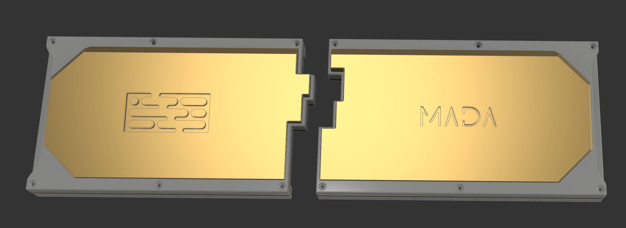

Update on the project:
Logo design is finished. Final logo placement and actual size will change, but below is a rough draft.
267687-0
Will order a 3d printer to print some prototypes to have a phyhsical piece. This is just to look at it assembled and perhaps do some more design changes to the case based on how it looks.
Ordering a new release printer which should arrive by July. Once the printed part is reviewed and any potential design changes implemented to call it final, we will release the final IC and order an actual prototype from the manufacturer.
Aiming to get the prototype in fall to do any minor tolerance tweaks. Once that's done we will proceed with the group buy.
Thank you all for your input. I will keep you posted on the progress. :)

Attached are a few shots of the Macroless/60% variant with winkeyless blocker top layer that I've printed in the meanwhile. Disregard the strange layout and modifiers, just using a keycap set that I had laying around that didn't completely clash with the black and gold theme here.

Are the blank slots part of the final design?
Offline Cinicle
  • Posts: 23
Re: [IC] Quefrency Rev.3 case 69Nice
« Reply #83 on: Tue, 07 December 2021, 00:50:41 »
The blank slots are just a part of the winkeyless top. The aim is to have different options available, but it will laregely depend on demand.
