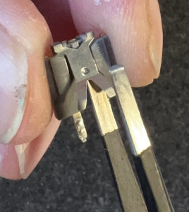

I just did this with a voltmeter, looking for full resistance when open and no resistance when closed.
There were a couple of switches that I had to 'tweak' to get them to register properly.
I found that a TINY bend here helped if the resistance didn't change. (bend to move the tines away from the switch plate)

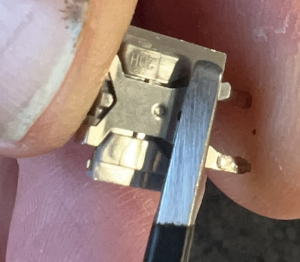

293076-4
Or a GENTLE push of the tweezers in here if they were always open, coupled with a TINY bend in the other direction on the tines of the leaf. (as above but bent towards the switch plate)
* IMG_8622.HEIC (1387.2 kB - downloaded 136 times.)
This can take a few attempts to get right and you have to put the switch back together fully to test.
