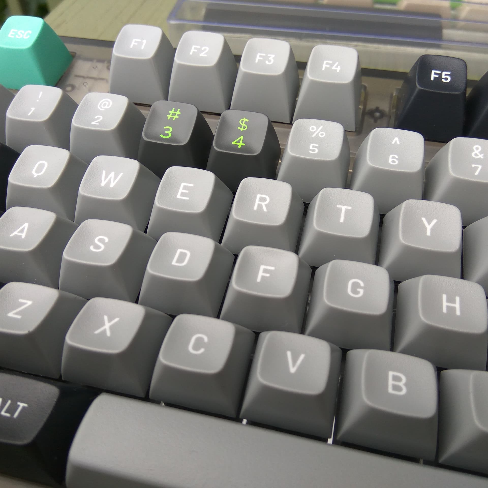

« Reply #2 on: Wed, 20 September 2023, 12:09:13 »
OK, I checked and it feels as though MT3 has a deeper scoop than MG.
At least, if we are talking PBT MT3, which is pretty well-made.
Here are two AF SA [shorter MG] keycaps on an MT3 board:
The PBT MT3 might be scooped a little deeper than anything you see in that image, though.
PBT MT3 has a deeper sound than MG, which is more higher-pitched and thin-sounding. However, I think that MG is sculpted better for typing. The dramatic scoop angles in MT3 are more likely to prevent the free movement of your fingers to the next row than occurs with MG.

Out of curiosity, on the picture you posted which keycap is which?

You can also see from the image provided earlier that MG / AF SA legends face you more directly than several MT3 rows. I think that makes MG more ergonomic.
