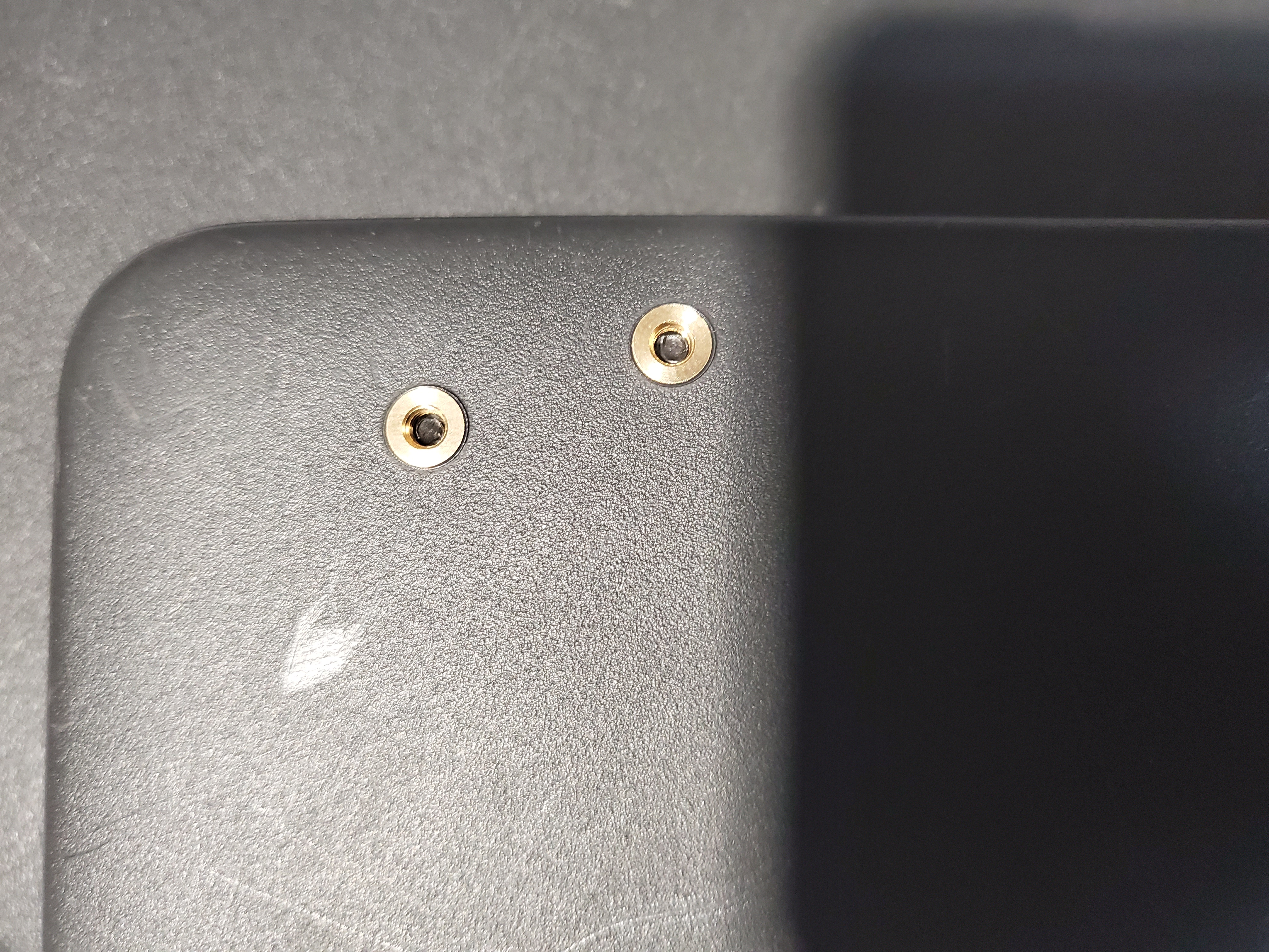

I haven't used them with a keyboard yet, but I really like these brass threaded inserts for repairing structural casing damage to Chromebooks. They have a flange, so they should help with providing more structural integrity than the original design. You would need to find long enough M3 machine screws for them though.
I drill out the cavity for the old insert all of the way through the case (or straight through the integrated standoff in this case) with a 5/32 drill bit and set the insert into the resulting hole with a soldering iron. The hole is just a bit too small without heating with the iron so that the insert has more surface to grab when it is installed.
The result looks something like this:
282855-0
You may end up with a gap between the insert and where the original standoff would originally have met up with another on the bottom half of the casing if going that route.
