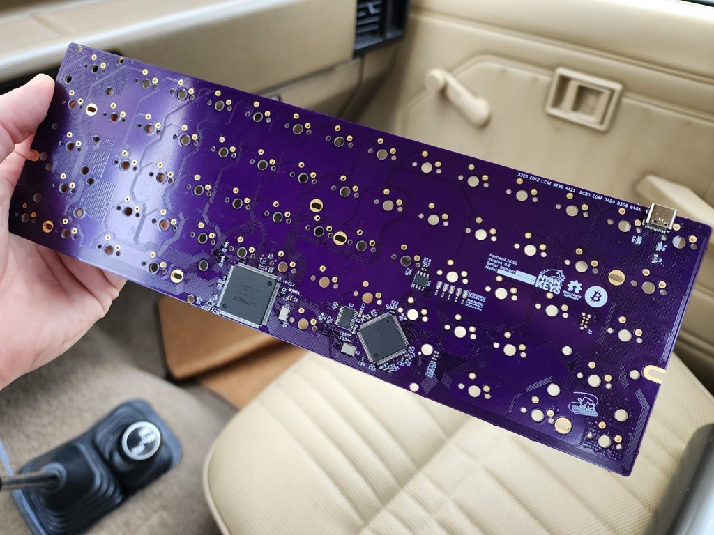

PCB Schematic and Layout

  • Lattice FPGA Ice40HX4K to handle debouncing in parallel
  • STM32F723 w/ USB 2.0 HS PHY for 8000hz polling
  • 1Mbit EEPROM for settings and FPGA Bitstream

The FPGA at the heart of Nyan Keys is used to handle the debounce of each key and high speed serialization of that data so that it can be pushed out over USB. Each key gets it's own timer core. As such all keys are parallel and do not require any diode and such! This also eliminates the need to scan a matrix since everything is happening in parallel.
The switch will arm instantly, then the state of the switch can't change until the debounce count is complete. After the count reaches the max value in [debounce time] the switch can then send over a new state instantly. What this means simply is that unless you are able to press keys at under 1ms you will not have any debounce time since the key would arm and release instantly.
The communication to the MCU that is the USB device is done via a DMA based SPI channel where 9 bytes are requested from the board at a time to represent each of the 61 keys as a binary 0 or 1. The current speed of the board can run the SPI bus at 12.5Mhz and Nyan OS can fetch a full state around 80k times a second. Which is 10x faster than what the USB bus can generate interrupts at. Using the FPGA to handle all of the debouncing instead of the MCU leaves the MCU free to send packets over USB without having to wait for any scanning to complete. This also leads into the fact that each key starts it's count instantly instead of waiting for the MCU to hit that key in it's scan pattern.
STM32F7423
MCU chosen to run Nyan OS (NOS) was the STM32F723 because of the high clock frequency and onboard USB 2.0 HS PHY. Having the onboard PHY means that there is no need for additional chips/traces to get the USB 2.0 pseudo differential signals to the STM32F& MCU. The amount of RAM is 256KB which is more than enough to handle the Nyan OS without issue whilst also allowing scancodes to be sent over to the host at the 8000hz bInterval rate. The onboard flash is also modest at 512KB and is more than enough to hold the code and string values needed. This MCU is overkill for a keyboard but because of the already high BoM costs of this board there wasn't a reason to start clipping coupons.
The MCU also has upto 16 USB endpoints of which Nyan Keys uses 2. As a USB device the Nyan Keys appears as a composite USB 2.0 HS device. The composite device consists of a CDC (Serial) endpoint used for configuration and a HID device.

This is a very interesting project. To my knowledge there are only a few keyboards which scan all the keys in parallel (and have NKRO without diodes), and at least two of them use PISO shift registers. Offloading part of the KB duty to a co-processor is not new: (imsai did it back in the day WEY did it more recently, etc). There has been a resurgence of this idea somewhat more recently. However, I'm not aware of any other projects using FPGA for this. I think it's a great idea. I have been considering novel keyboard matrix scanning tech (just for fun) and had not considered this.
I would expect the 1xn matrix trace routing to be quite complex, but you managed it well with 2 layers: well done!
According to Digi-Key, the FPGA has 107 IO, and I see there are 4 SPI pins to the MCU: can this idea be extended to a size larger than 60% ?
edit: reading the schematics now. I see between 32 and 40 IO pins which look to be unused, but I don't know FPGA well enough to know if they can be utilized. Of course it's the full bottom edge: hard to route I'd imagine. With it being so physically large, finding space for the FPGA would be hard.
I assume the little squares on the copper are decorative, but if you ground them with vias, then you would make an efficient backside reflector metasurface for approximately 77 GHz radar.

So this weekend I decided to produce a few Nyan Keys PCBs for people who are interested. The versions are the .9e which supports DFU mode to enable firmware updates without the need for a Tag Connect programmer! These boards also have all of the small issues with the first prototype board resolved such as the D+ and D- lines being swapped! This board is Perfect!
With that said price per PCB would be (130 USD or .003 Bitcoin) + Shipping, currently I have 4 available because one sold and will have 5 more coming pretty soon. Spending all day soldering boards was tedious to say the least but with the new stencil method things are moving along very nicely!
So why the high price tag?
  • Oshpark PCBs (Made in the USA - Ex. Quality
  • BoM cost, No expense spared on components, STM32F723 MCU - Lattice Ice40HX4k FPGA
  • Kester R276 Solder Paste + Steel Stencil
  • Engineered by me! Hand assembled by me!
  • Time - Each board under best conditions is still 1-1.5 hours to assemble and flash.
Thank you all for reading and just send me a DM if you want a PCB!
