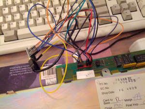

These jumper wires are great for quickly hacking a Teensy inside most IBMs...
37250-0
I probably should have though of this but I still had a small pigtail of the wire left inside the case. So I just solder this to a perfboard with a dip socket for the teensy.

There's a connector there that looks like two rows of Teensy pins side-by-side. It's where the cable would normally plug in to the PCB.

Hi,
I have 4176191 for 5291.
I used the controller from soarer on teensy 2.0.
Soarer_controller_v1.20_beta4_atmega32u4.hex.54190-0
I used scaswr to upload and hid listen to listen.
The teensy is wired directly to the pcb pins like is shown in a picture earlier in this thread.
My question is, that after all of this is done, the output I see on hid_listen is bizarre.
it consists of masses of data.
I tried with the config 'bigfoot' but when I pressed a key, it would type something like "-.36QE258O.P/"
Or close all my windows, open a window and type randomly, which was seen earlier in thread.
I made simple alterations to soarer config with everything unassigned.
On hid_listen the out put was about 500 characters of the form
"/03 \5E /12" etc. whenever I press a random key.
When nothing is presed on the keyboard nothing seems to happen.
I feel this is likely electrical/wiring.
I have provided a picture of my wiring.
The ground wire is something that might be a concern as I thought it might be necessary.
I do not know about it though and have a novice understanding of all of this.
Regardless, what is my course of action?
Is this a wiring issue or is it a mistake I made in setup
edit: also putting my hand near it seems to be picked up on hid listen?

« Reply #30 on: Tue, 11 February 2014, 14:17:37 »
Try replacing the bolt that holds the PCB to the backplate - that makes an important ground connection!
Offline SneakyRobb
  • Posts: 42
Re: IBM Model F 5291 Terminal (bigfoot) Keyboard
« Reply #31 on: Tue, 11 February 2014, 14:30:17 »
This has worked!

Hello everyone from Spain. Why I'm telling were I am? Because that will tell you that my IBM Model F "Big Foot" is NOT a 5291 but a 8521. Not that they are much different, the caps have different legends (Spanish text) on them and the pinout may be different (yet I doubt it, but I want to be sure). The missing pin on the connector that goes to the terminal is in the other side and VCC is also misplaced! Despite the pin heather in the board apparently having the same pinout, I want to be sure its is the same. Does anyone have the pinout for this one, so I can build a converter? Thanks!
Also, the jumpers 1,2 and 4 came shorted in my keyboard, but I don't see that being the case on your keyboards, you only seem to have the number 0 shorted. Why is that?
« Last Edit: Tue, 17 March 2020, 20:26:44 by Jaki1122 »

Hello, not sure how active this is anymore...  acquired 4 bigfoots as of about a week ago and went to do this and followed directions to a T.  Somehow I'm just getting lots of keypresses on all of the bigfoots. I thought the board was bad so I went ahead and converted another with another teensy 2.0 just rule both out and had the same outcome keypresses would look like (see below). My converted model f xt looked normal and used that as an reference of what "normal" should look like.
(bigfoot output)
\17 +25 \1F +26 d25 d26
/17 -25 /1F -26 u25 u26
\13 +24 \1B +53 d24 d53
/13 -24 /1B -53 u24 u53
\50 +43 \58 +E1 d43 dE1 \40 +64 \48 +40 d64 d40
\24 +37 \2C +2C d37 d2C
/24 -37 /2C -2C u37 u2C /40 -64 /48 -40 u64 u40 /50 -43 /58 -E1 u43 uE1
\50 +43 \58 +E1 d43 dE1 \40 +64 \48 +40 d64 d40 \2C +2C d2C \24 +37 d37

Hi, I have the same problem with 3 bigfoots.
I connected the teensy 2.0 like described in the guide above and flashed the bigfoot.sc on the teensy with the 1.20 beta4 version.
I mostly get 2 or 0 characters per key press.
I played around with the soarer settings like scanrate a bit but no change.
Any suggestions?
Offline AngryC
« Reply #45 on: Tue, 14 May 2024, 02:12:38 »
I discovered something:
When I press M it outputs "nm". But when I hold the M key, it only outputs "m".
So the "n" comes in on the upstroke it seems. Same with other keys.
Offline AngryC
« Reply #46 on: Tue, 14 May 2024, 05:47:17 »
Ok, I found the issue:
The guide above is wrong: Wire 2 and Wire 3 need to be each one pin above!
Here is how you connect the keyboard to the Teensy:
https://deskthority.net/viewtopic.php?p=519579#p519579
