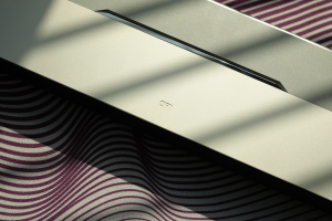

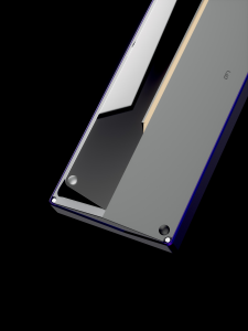

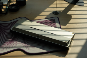

Hello everyone, I’m David from OF Studio!
I’m excited to introduce our first 60% keyboard — OF 1.
Join us:https://discord.gg/fvarxEkcU5
Design Philosophy:
“Freedom Within Order”
When visual symmetry is subtly broken, and change brings unnecessary burden, we choose to start anew.
The OF 1 is our exploration of pure form:
   •   Visual Order: We abandoned compromise curves and reshaped the contours with precise calculations. Every edge follows visual symmetry, achieving a calm and balanced geometric aesthetic.
   •   Inner Freedom: We innovated the core structure to free possibilities from redundancy. It is designed to adapt and evolve without adding extra burden for every experiment.
Find stability in order, embrace change in simplicity — this is the spirit of OF 1.
Render as follows:
314887-0314889-1314891-2

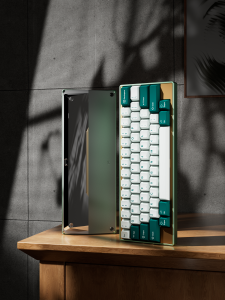

The following is the second type of top cover. Compared with the first type of magnetic arrangement strip, its cost is much lower. In terms of structure, it is not as radical. Through understanding, we found that most players still prefer an integrated top cover. This feedback will lead us to decide to change to an integrated top cover. The good news is that the cost will be significantly reduced.
314901-3

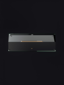

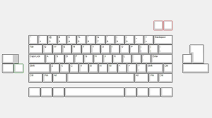

Structure & Innovation
Many enthusiasts struggle with this: trying different layouts usually means buying a whole new top case, increasing costs and storage needs.
OF 1 breaks this convention — switch layouts without changing the top case.
   •   Freely switch between multiple layouts
   •   No extra cost or storage required
   •   Full control back in your hands
This keyboard is not just a tool, but a statement: find peace in order, spark creativity in freedom.
Through this IC (Interest Check), we aim to gather real feedback from the custom keyboard community to better understand opinions on this structure.
314893-4314895-5314897-6

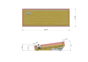

Project Details
Keyboard Specs
   •   Layouts: 60%, WKL, HHKB, WK
   •   Angle: 8°
   •   Front Height: 17.17 mm
   •   EKH: 22.69 mm
   •   Weight: 2550 g
   •   Mount Style: Top Mount + O-ring
   •   Colors: Black / Silver / Misty Mint / Tranquil Blue
   •   Manufacturing: OF Studio in-house production
Materials
   •   Top Case: 6063 Aluminum (205 Zirconia Sandblasted)
   •   Bottom Case: Brass (180 grit Sandblasted + AF)
   •   Plate: 1.5 mm 5052 Aluminum (plate design open-source)
   •   Weight: 304 Stainless Steel (Mirror Gray / Sandblasted Gray)
   •   Top Case Layout Strip: Brass / PEI (TBD)

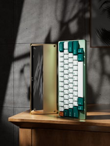

   •   First prototype completed
   •   Some detail adjustments finalized
   •   Second prototype manufacturing in progress
314899-7

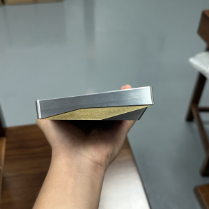

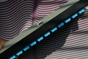

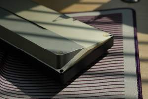

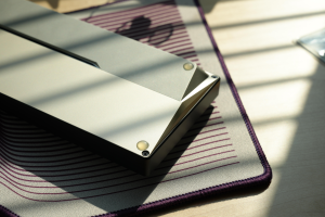

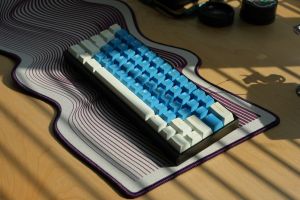

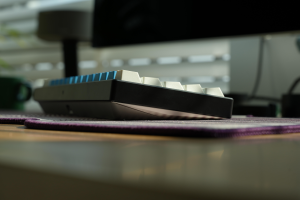

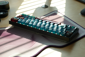

Latest actual photos of the sample
315734-8315736-9315738-10315740-11315742-12315744-13315746-14315748-15

6u HHKB support would be awesome

Now the 6u is too rare.

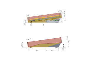

Love the simplicity! Side profile ratio could be tweaked a little bit. GLWIC!

Thanks! Really appreciate it — glad you like the design. I’ll take a look at the side profile tweak!

The adjustment on the side, as well as the replacement with an integrated top cover
314911-0314913-1314915-2314917-3

Thank you for your suggestion. I have adjusted the side profile without compromising my overall design style.

The actual photos of the new sample have been updated. We will soon have them available for immediate sale.
