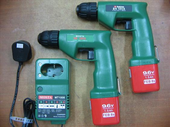

Other alternative I am considering is a cordless drill since I can use it as an electric screwdriver as well?

What about the cordless drill, I'm just showing an example but what if I get name brand cordless drills such as Bosch, these have a low spin speed, not sure aboutthe amount of torque on it however.

Also, I was wondering if a brand name, say Bosch, Cordless drill would do the job too?
