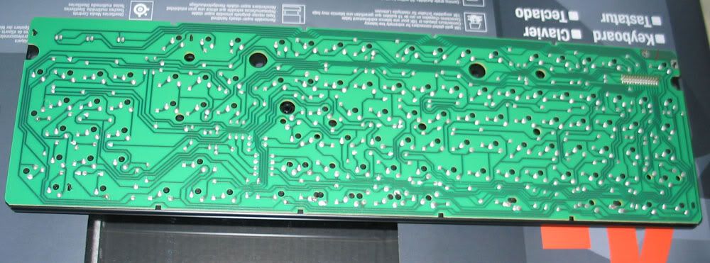

I've only owned my FKBN104M/EB for a couple of weeks now, but after a few beers and a late night at the computer I couldn't help but wonder what its guts looked like. Naturally, I pulled out the Phillips and butter knife duo and got to work on the casing (In which I'll say was very easy to remove! There are only 4 clips on the bottom side of the case - No sand-paper edges here). Within a minute or two I was staring in awe at what I can only describe as the anatomy of a very well produced keyboard. Joy.
After ravishing the PCB with my eyes and removing a few key caps, I found myself fixated on these Brown Cherry MX Switches, so beautiful and sleek. But more "importantly", the lovely shaped indents on the switches which invited the company of a little LED. I had never experienced or appreciated Cherry MX Switches this closely before, and this came as a little bit of a surprise that the switches were built to accommodate such enhancements.
Now, I thought to myself, I had already spent around $230 on this keyboard (Shipping and charges included), I couldn't possibly make a pretentiously vain attempt at spending even more money on this board and modding it to look like it was throbbing with radioactive gorgeousness to exploit my limited knowledge in electronics, could I....?
Short answer; Yes, definitely! I'm far too fixated on this idea to leave it behind.
The main problem I see at the moment is the fact that each and every switch is mounted onto that chunky metal plate, and soldered directly onto the PCB, seemingly leaving no room for any kind of leeway to achieve this recently developed dream. Upon further examination, the switches seem to be rather simply designed and I wondered if they were easy to dismantle? If wires could be fed through the switches themselves, I'd have no problem at all guiding them where I need them.
The mental image of de-soldering 200+ contacts AND replacing them without any bends or breaks doesn't really appeal to me so much. I'll probably end up giving it a go if its the only way, anyway. But this is what scares me.
Let's hear your thoughts on the matter, geekhackers! I've got a good camera to make a lovely big mod-post if/when this goes live :)

As far as aesthetics go, I really wouldn't like to be able to see the LED's while they're not in use. The gaps in between the keys are not great but it would definitely be noticeable.
Looking at the switches from above with a light source underneath the PCB, you can clearly see two pin holes for the LED's to sit into. I wondered if these holes were in the bottom half of the switch casing, or the top half - Dictating the possibility of a much easier installation

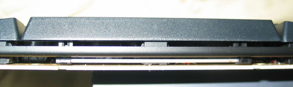

Sorry to hijack this thread.  I have a Steelseries 7G using a Cherry MX Black switches.  I"m wondering if I could snap the switches open without having to open up the board.  This reason is that I want to know what causing my SHIFT key to grind onto something and making it stuck while pressing down.  I see that the G80-11900 also uses the Cherry MX Black switches.  Can I use the same method by using the hook and where do I place the hook?
http://s918.photobucket.com/albums/ad24/KAI_BRUNNENG/?action=view¤t=SHIFTKEY.flv
« Last Edit: Sun, 09 August 2009, 20:00:00 by LEXX911 »
Offline sixty
  • Posts: 984
    • http://deskthority.net
Can you open MX Switches?
« Reply #10 on: Sun, 09 August 2009, 22:49:56 »
Quote from: LEXX911;108510
Problem here might be the stabilizer not the switch itself (switch looks fine on the picture). However the steel series uses plate mounted switches.. there is no way to open them (or remove the stabilizers) without desoldering them.

I really don't like the stabilizers on the Filco. Please don't flame me for this but a couple nights ago I was playing TF2 on my blue cherry tenkeyless and I got thirsty so I went to go open a bottle of snapple. I got mad because we lost the game and accidentally spilled some on the left shift key. It was a pain to put the shift key back in because of the stabilizer. But yea I was heartbroken in general because I dirtied my lovely keyboard =( lmfao!

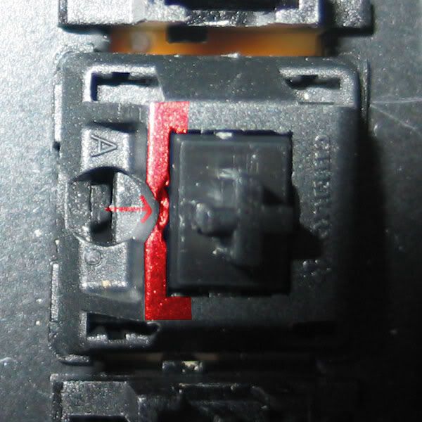

Can't reach the stabilizers if you mean the stabilizer bar as the metal piece.  It's sandwiched between the board holding the switches and the circuit board.  I have no clue how to remove the top switches mounted to the board from the circuit board.
The SHIFT key stabilizers gets stuck or hit something if I'm holding or pressing the key down above the word SHIFT(I think this tilt the stabilizer bar on an angle or out of alignment) but it goes down very smooth if I push it straight down with my finger below the word SHIFT.  But the right SHIFT key doesn't have this problem no matter where I'm putting the pressure.
« Last Edit: Mon, 10 August 2009, 01:01:11 by LEXX911 »

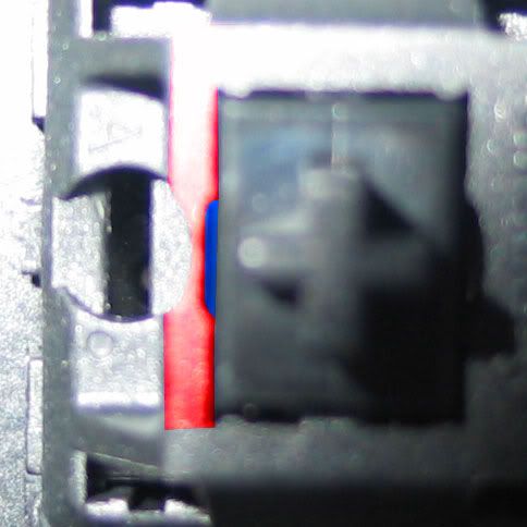

The longer key stabilizers are similar in frustration on the Cherry. The only difference I found, is the counter points where you mount the stabilizer to is attached to the PCB on the Cherry boards. When removing a key, you have a chance of pulling the stabilizer mount point off the pcb itself, and then it's just like the Filco, a free moving piece of plastic you have to put back in. In all though, they're very durable, and can take a beating yanking on pieces (assuming the plastic isn't brittle or old). Hope you got it all worked out
Offline nanu
  • Posts: 290
    • http://T-T.be/portal
« Reply #14 on: Mon, 10 August 2009, 10:35:11 »
I assume you've pressed the switch itself without the keycap, or put a square keycap on it to test the switch independent of the two stabilizers to its sides.
I would uncase the board and check how the stabilizers are clipped onto the metal switchplate.  Peeping from the side, you might figure how to remove the left one, but unlikely the one to the right, depending on how it's attached.
EDIT: Oh, I see. the metal balancing wire is embedded, too? :/

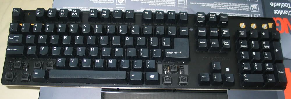

This is what the board looks like without the case.
I don't know if I can open this up.  Should I RMA the board? The SHIFT key is very annoying since I use it alot.

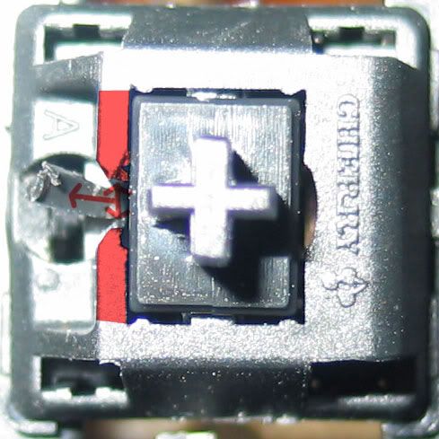

Woohoo!  Found the problem!  Turn out it just the faulty plastic of the switch that wasn't molded properly and was too close to the switch.  So everytime I push down on the SHIFT key it makes contact with the plastic piece at the top.
Here's what it should look like:
So I did surgical cut with the exacto knife and all is good and smooth once again.
Thanks people for the help.  I'm glad I didn't decide to pull the thing apart.

I think if I had that blue cherry switch.  I don't think the faulty plastic pushing in would affect it.  Seems to me the + on the cherry blue switch is further away from the edge then the black switch.
I'm not surprised one of these faulty switch gotten through.  I can imagine someone sitting there with a big magnifying inspection glasses going through hundreds of these.  Years ago my brother brought these tiny plastic pieces and offer me a job of inspecting the the good and faulty one and without a magnifying glasses either.  I give up doing it because I couldn't see the difference between the good and the defective one.
I've read somewhere on this board that someone who also own one of the Steelseries 7G is also having this issue but never thought about it because he avoid it by pressing it at a proper angle or place so that it doesn't make contact.
But you're probably right that the good batches somehow gotten damaged during some process.
