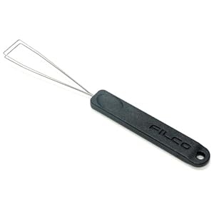

1) Use good keypuller like below
2) Do be very careful when you pulling out the keycaps at Thumb cluster. I had few time pulled out the top portion of Cherry Switch. :S

Great, thanks! Would you recommend using the Filco keypuller as opposed to the keypuller that comes out of the box with the Kinesis advantage?

I personally recommend using the keycap puller that came with the keyboard. It looks like this but beige:
The reason is because it's shorter and can only grab the keycap edges. When using a longer wired keycap puller, there is a chance that when removing the thumb keys you can accidentally pull the switch itself and break it.

I've taken the keycaps off my Kinesis Advantage many times to put on/take off orings using the key cap puller that came with the board. Never a problem.

Great, thanks! I will just use the keycap puller that the product comes with. By the way, which o-ring modifications are the best?
Hmmm, I just used my fingers. Am I crazy. ;)
Offline Lanx
  • Posts: 1914
Re: Installing O-Rings on Kinesis Advantage keyboard
« Reply #14 on: Thu, 21 February 2013, 02:14:55 »
i have used my trust butterknife for at least 1,000 keycap removals.
when i couldn't be bothered to go into my kitchen my swiss army knife worked fine,
no injuries so far!

  • I used the same puller that natas206 suggested, and it does generally work well. Be careful to ensure that it's clipped over both sides before pulling hard to prevent damaging the switch.
  • Some keys are harder than others. If you're having trouble getting it to snap over both sides, you can try sliding it in from the side. For 1x1 keys, you can also try rotating the puller 90 degrees and coming in from a different direction.
  • The hardest keys to pull with this puller are the 8 home keys. It'll tend to hook one side or the other, but not both. Either very carefully position the puller, or remove the keys around them first, and then pull these caps off with your fingers. If you have a wire puller, I'd use that just for these 8 keys.
