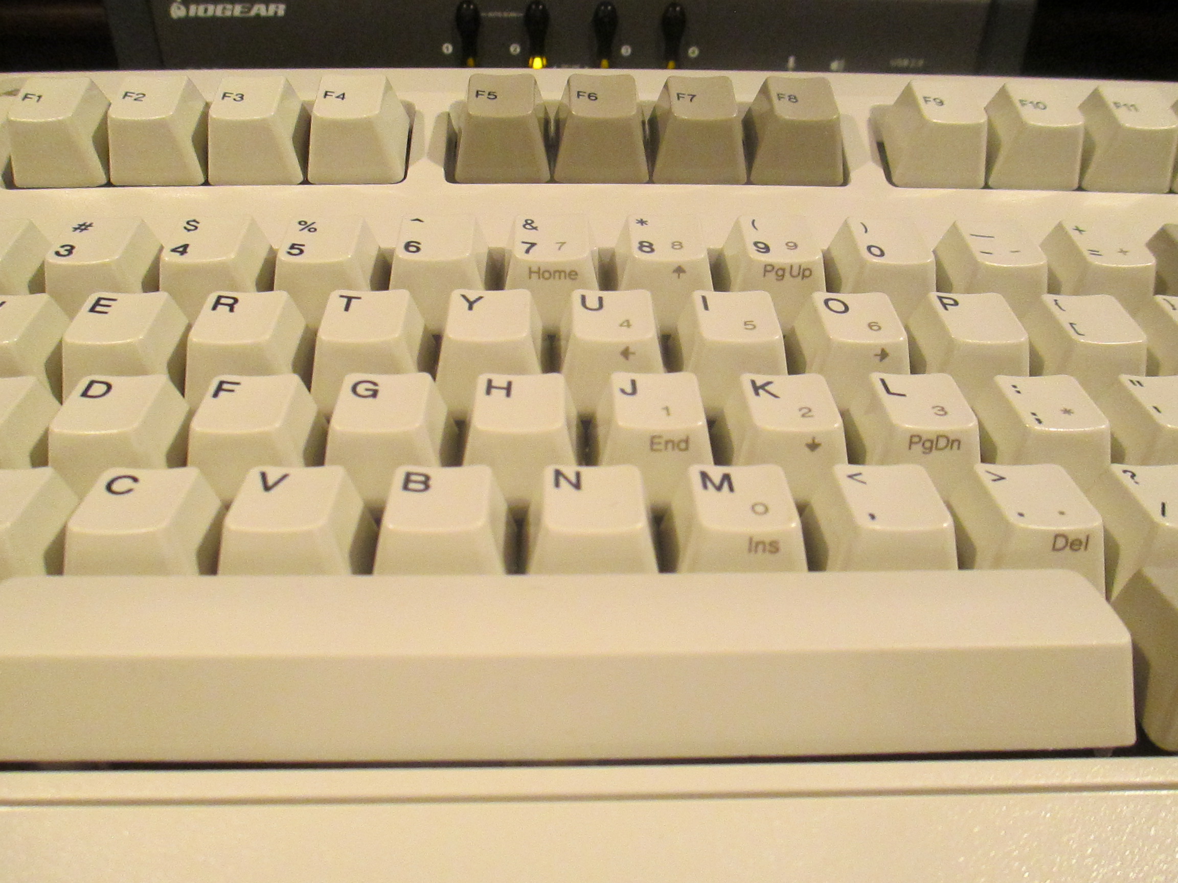

Yesterday, I unboxed my NIB IBM Model M Space Saving Keyboard (SSK), birthdate 13 September 1990. See below for a closeup view of the PBT dye-sub keycaps, showing the extra legends for the embedded numeric keypad and navigation keys.
29598-0
Although I rarely use the embedded numeric keypad or embedded navigation keys, this is a nice touch that is not found on many TKL boards (the RF 87u is the only other board of which I am aware that has this feature -- please let me know if there are others).
