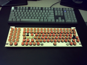

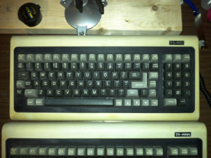

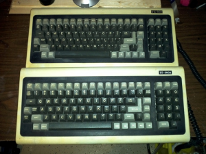

This is mostly a thread to add some information to the GH collective, and as a build log for a hardwired version using a Teensy controller.  I don't expect a lot of people to rush out and source these obsolete keyboards, the linear switches they use are really stiff, more so than Cherry MX Greys.

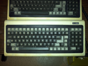

I recently acquired three different Televideo keyboards; TS-800A, TS-802, and a TS-825 (800A and 802 shown below).  All of these have plate-mounted Futuba Complicated Linear switches, documented quite nicely on the DT Wiki: http://deskthority.net/wiki/Futaba_complicated_linear
38323-0
38325-1
38327-2
Cases are varying degrees of yellowed, seller said these were stored on a shelf.  I've been Retr0briting them over the past couple of weekends, two have cleaned up quite nicely, but the third is still a shade of taupe along the lower leading edge.

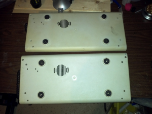

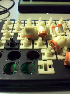

The cases on these are burly; four screws hold the feet on, four more hold the case halves together, and four screws secure the plate to the lower case half.  Non-adjustable feet, the case is a massive wedge to hold the rear up at the right angle.
Keycaps seem to be SS-profile.  Really thick, with Cherry-compatible stems, but each stem is set at an angle, so the keycaps are level only when the keyboard is raised in the rear.

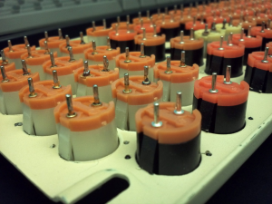

Switches can be removed once the PCB is desoldered (whole lotta pain doing that...), and come in different varieties.  There are plate-mounted stabilizers only for the space bar, and one lock switch for the caps lock (the black one in the pic).
38333-438335-5

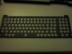

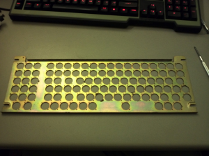

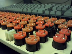

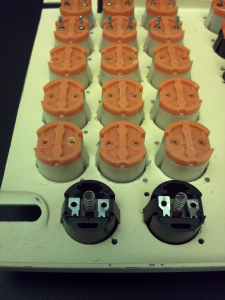

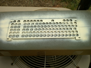

Plate is painted black on top, underneath it has some sort of metal finish, but age is taking a toll so there's some rust around switch openings.
38339-638341-7
I've painted the metal plate, using metal-etching primer and Navajo White paint (kind of a cross between eggshell and sand).  It's now a shade or two darker than the case, but most of the plate isn't visible once the keycaps are in place.
38343-838345-9

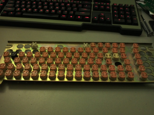

Switches are back in the plate now, I used a mix of the stock switches along with some NOS switches from Electronic Surplus - $3.00 for a bag of 20.  http://www.electronicsurplus.com/Item/150004/FUTABA%20-%20Switch_%20P_B_%20NO%20Keyboard_%20Package%20of%2020_%20-%20MD-4PCS/
38347-1038349-11
As long as I had the keyboard apart, I've been lubing all the switches with Mkawa's GH lube.  Each switch is held together by the two pins, which are actually screws:
38351-12
