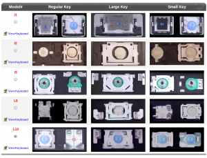

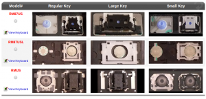

I attached two files showing the switches in T4x and x6x keyboards. Images are from a site that sells individual keys.
T4x Switch Types
34123-0
x6x Switch Types
34125-1
As you can see, I2 from x6x and RM87USL from T4x are the same. My guess is Lenovo kept using this switch for a while after acquisition.
