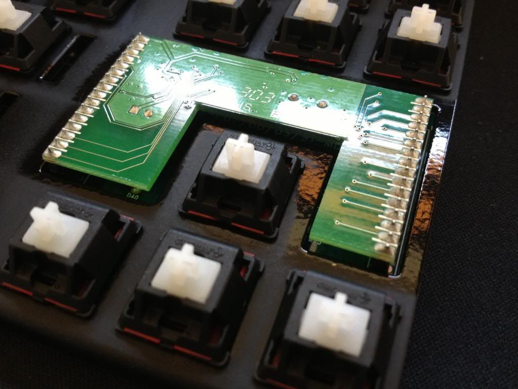

  • philanthropist
  • Posts: 1494
Re: What...have I done?
« Reply #23 on: Sun, 06 October 2013, 06:53:13 »
It is located above the arrow keys, take the top case off to see it:
Offline mrelectric
  • Posts: 64
« Reply #24 on: Sun, 06 October 2013, 07:00:13 »
hmm, I've taken the top off, but I cannot see the controller pins

You can see the controller though?
Offline mrelectric
  • Posts: 64
« Reply #26 on: Sun, 06 October 2013, 07:04:18 »
I have found something similar in the top right hand corner of the filco though, it looks exactly the same as your pic.
Offline mrelectric
  • Posts: 64
« Reply #27 on: Sun, 06 October 2013, 07:05:39 »
No I cannot see it in the place you have shown me. One sec I'll take a pic ^^

Offline longweight
  • philanthropist
  • Posts: 1494
« Reply #29 on: Sun, 06 October 2013, 07:17:27 »
Ahhh sorry I thought that you had the TKL version.

Offline BliTzKiN
  • Posts: 142
« Reply #31 on: Sun, 06 October 2013, 08:30:35 »
Hey! That picture was from the build log of my Ergoclear Filco :) I thought it looked familiar. Anyway, like what they said, submerging in water should probably be your last resort since there's a high chance of frying something. You could try putting the PCB together with some rice since they absorb moisture pretty well, might be a chance that it still works.
