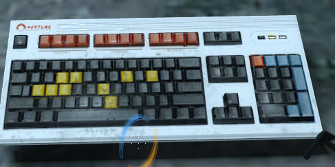

Like others before me...
 :rolleyes:

Hehehehe. I was thinking on making that as well. If you are not in a rush I have a groupbuy open for Cherry thick black PBT. Then you would only need few keys from white set to dye. All of those colors come out very good with RIT.
Assuming you have the white keyboard, you could sandblast the legends off the stock PBTs so they are ready for dye.

Ah, the Aperture keyboard. :D Hmm. I have also considered that, but with keys with legends still on them.
I snatched the cooling vents from a broken Commodore 64C, and I have a few spare Cherry cases ...

I thought of using legends too since I never actually typed on blanks before, but I want to stop relying on sight for my typing, and in this case accuracy actually works in my favor. :D

That purple is beautiful, my favorite color too... :D my only worry about dyeing the etched keys is actually the yellow keys, I can deal with the blue and red ones but I think the letters on yellow would be a little more distracting than I'd like. Plus I wanna try typing on blanks anyway.  :rolleyes:
