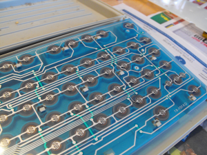

I went to a pawn shop I'd never been to before today and looked at their old 5$ keyboards. The majority (2 out of 3, yes they only had 3 keyboards) were genuine garbage, but one felt kinda nice and had an unusual stem as well as AT interface. It's branded as QTronix QX-101, and I've googled that but couldn't find anything, so I thought it would warrant a little thread on here. I've disassembled it and discovered this:
54254-0

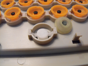

Has anyone seen this before? It looks like it's technically a rubber dome keyboard, but I've never seen one where all the domes are just freestanding like that. It doesn't look very economical. It does, however, feel markedly nicer than your run-of-the-mill keyboard. The construction is kinda neat. In the picture above you can see there are two colors of domes, the white ones are probably stiffer (the enter key has a white dome too).
54252-1
There are a bunch of hooks which the conductive membrane slides into, then a plastic back (which can just barely be seen in the upper right corner) slides on top and is screwed in four places. I would've taken more photos to show how the conductive membrane itself bends into the controller, the controller itself, the AT interface, the white cylindrical stem with a cross in it, and the layout featuring a bigass Enter key (eww), but my ****ty camera died on me. It stops working when batteries reach 1.4V instead of 1.5V...

Discrete conductive domes over single-layer membrane. I had a Dell keyboard like that once (I don't recall if it was dome over PCB or membrane, but I had to keep hooking out domes and cleaning them after they stopped passing current), and I think I had an office keyboard similar to that at one stage. I think the original Apple iMac keyboard also had discrete domes, as did the Alps AppleDesign keyboard, although the latter certainly was pressure dome (three-layer membrane).
I've seen that design of slider before, or something very similar — I thought alps.tw had some photos of a Chicony or some such board with those switches, but I don't have the page bookmarked.
