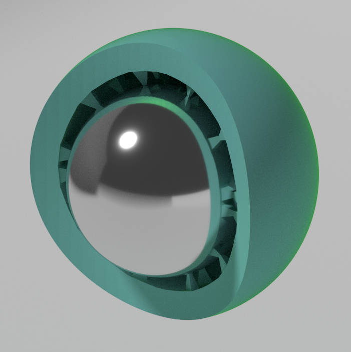

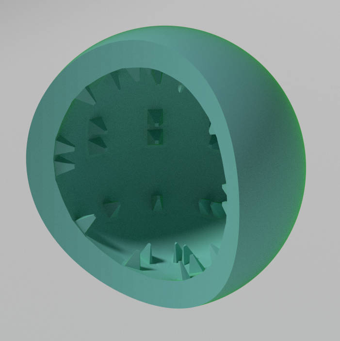

You could try something like this, with plenty of lube:
118411-0
118413-1
Oh, hey, I have an idea.
LET'S CALL THIS THE IRON MAIDEN TRANSFER UNIT  :cool:
Should be printable if prepared right. (assembled from 2 halves probably)

118973-1
And there it is, one half of the resin ball out of its mold. I had to peel off the inside. Outside got damaged, either due to heat, or chemical reaction. Didn't influence the ball.
118975-2
Calipers. A little bit under 75mm. AFAIR I designed it this way, too lazy to check now. I'll make the other half this weekend and compare. If they won't match, I'll change the molding process.
Vertical measurement is perfectly consistent (=diameter/2).
118977-3
BTU test station, muhaha.
You can see the air bubble. I'll fill this in later with resin. Polishing process will get rid of any irregularities.
Didn't weight it, but I think it's around 40 grams. Used 45ml of resin for this.
118979-4
So, then I tipped it...
118981-5
... and it levelled itself out when I let it go ;_;
118983-6
This is surreal.
Feels a bit rough when under load, and it looks like the BTUs are the issue, but I have at least 2 tricks in my sleeve to smooth this out.
You'll see, if I live long enough.
