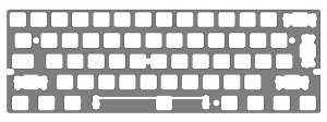

Anyone able to confirm this is correct (plate design)
« on: Sat, 02 August 2014, 03:21:28 »
I've created my own layout, in conjunction with Ivans Dolch buy to remove of of the keys which are duplicated on a UK ISO layout. I pinched a ansi and iso plate design and merged them together to produce this. My question is that are the measurements correct for a 60%? This can work right?   Just need the extra cherry stabs for the other large shift.
also the space bar holes, they look all correct?
Lastly  anyone know any artisan peeps that would be able to cut this for me?
