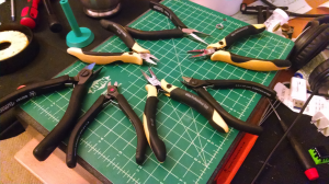

I took this picture for JayK, but this is my working collection of hand tools:
54469-0
i use every single one of those nearly every day; none of them cost less than 40$/ea, and those are only the ones that have survived. over the years i've owned probably in the dozens of small hand tools. these are the best of them that i've found so far; the flush cutters are mostly carbide and resharpenable swedish made by larsen, the pliers and oval cutter are wiha germany drop forged tool steel with full polish, etc. etc.
small hand tools for the electronics hobbyist are a bit like knives for a chef. you only need a few, but the ones you have have to be absolutely 100% reliable. when you're soldering down that 40$ tfqn-240 IC, you really don't want to make any mistakes.

these
http://www.amazon.com/Wiha-32742-Pliers-Straight-Serrated/dp/B002R0EI3G/ref=sr_1_1?ie=UTF8&qid=1392424876&sr=8-1&keywords=wiha+32742
are the short snipe nose serrated pliers pictured above. they are my go-to for 90% of plier-related tasks.

zeal asked me about my inventory of cutters. i wrote a novel. bwa!
wiha 32705 -- great ergonomics like all the other wiha professional germany line, excellent cut-out box-joint. they have worn well, pretty evenly, but there's a black oxide coating on the cutting face so i don't know how they're going to do after their first sharpening (fwiw i've had them a year and haven't needed to sharpen them). they weren't super expensive though, so good value, but not the best you can buy. supposedly they're drop forged full polish steel, but somehow i have some oxidization on mine. hmm..
wiha thailand Z40 1 03 128 -- waste of money. skip it. i had 4 sets of wiha thailand tools and gave 3 of them away.
larson 915201 -- http://www.edsyn.com/index.php?Mode=piw&pn=KP9152 i love these nippers. first of all, all larson joints are bolt-tightenable, period. second, no coating to make them harder. they are just very hard steel. these are my favorite small wire cutters. tiny head gets into places the bigger heads can't, but they maintain a 1mm max diam cut. full flush and just the right angle to get flush up to pcbs.
larson 9357 -- these are actually my newest. i wanted something in between the gigantor 955 and the tiny 915. they're pointed head and flat on the non-cut side, which is nice for offset snips. same fantastic quality as the rest of my larsons.
larson 955101 -- these were my first larsons and convinced me that wiha thailand was full of crap. these are my favorite snips and were 70 something iirc. they're not listed on the website, so they may be out of stock, but i could swear i saw them still up on display last time i was at edsyn, so i can almost certainly get them for you -- or the 9551 if that is all they have left in stock. they're full flush and i think they're vanadium tool steel (actually i think all the larsons are). they're rated up to 2mm and they cut up to 2mm copper with panash. they've also cut some crazy thick wire i've had around when i was too lazy to get my wiha gigantic hammer anvil cutter out to cut. i've sharpened these at least twice and they're still cutting crazy wire. (note they need to be sharpened with diamond or really fine carbide. micro-mesh and DMT diamond has worked well for me. i start with a roughing at 2-400 grit and end at 8-12k grit on the micro mesh.
