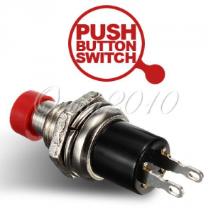

I want to add a teensy reset switch to the backside/underside of a custom keyboard.
Can anyone suggest a good type of switch for this, preferably available from ebay/online for cheap? The cheap momentary panel-mount switches that I have found on ebay are all too big to be useful, eg:
57369-0

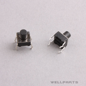

There are lots of good pcb mount/smd small switches available, I just need a good flat one like that, but with a thread so I can mount it to the panel hole.
I guess I could drill a hole and glue one of these in, but I'd be worried that the glue wouldn't hold... They are very cheap...  ;)
57371-1
