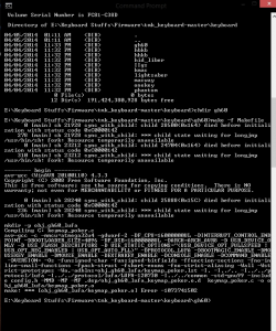

Alright I tried again and didn't work I got the same issue as the first time.  I extracted the entire TMK zip file and then copied the GH60 folder so I didn't muck up the originals.  Here is the code I currently have in order of what working on it following Matt3o's guide.  I think where I am getting stuck is the last or second to last one where you are actually doing the keymap.  Though I could be way off base.
This is the Makefile file that is the starting point.

This is what I get when I attempt to make it.
60003-0
I moved this stuff back to the stock directory and tried again and this is what I get.
60005-1
Edit:  Got rid of the WALL of code.
Edit:  Adding pic of the issue with I attempt to make the firmware.

Alright guys I make those changes.
I opened up Makefile in programmer's Notepad and then clicked on "Make All" under the Tools menu.  It then puked out this.
Code: [Select]
> "make.exe" all
      0 [main] sh 31896 sync_with_child: child 23888(0x150) died before initialization with status code 0xC0000142
  22525 [main] sh 31896 sync_with_child: *** child state waiting for longjmp
/usr/bin/sh: fork: Resource temporarily unavailable
      0 [main] sh 17412 sync_with_child: child 14776(0x150) died before initialization with status code 0xC0000142
  36615 [main] sh 17412 sync_with_child: *** child state waiting for longjmp
-------- begin --------
avr-gcc (WinAVR 20100110) 4.3.3
Copyright (C) 2008 Free Software Foundation, Inc.
This is free software; see the source for copying conditions.  There is NO
warranty; not even for MERCHANTABILITY or FITNESS FOR A PARTICULAR PURPOSE.
      0 [main] sh 31072 sync_with_child: child 32248(0x148) died before initialization with status code 0xC0000142
  12170 [main] sh 31072 sync_with_child: *** child state waiting for longjmp
mkdir -p obj_gh60_lufa
Compiling C: keymap_poker.c
avr-gcc -c -mmcu=atmega32u4 -gdwarf-2 -DF_CPU=16000000UL -DINTERRUPT_CONTROL_ENDPOINT -DBOOTLOADER_SIZE=4096 -DF_USB=16000000UL -DARCH=ARCH_AVR8 -D USB_DEVICE_ONLY -D USE_FLASH_DESCRIPTORS -D USE_STATIC_OPTIONS="(USB_DEVICE_OPT_FULLSPEED | USB_OPT_REG_ENABLED | USB_OPT_AUTO_PLL)" -DPROTOCOL_LUFA -DBOOTMAGIC_ENABLE -DMOUSEKEY_ENABLE -DMOUSE_ENABLE -DEXTRAKEY_ENABLE -DCONSOLE_ENABLE -DCOMMAND_ENABLE -DVERSION= -Os -funsigned-char -funsigned-bitfields -ffunction-sections -fno-inline-small-functions -fpack-struct -fshort-enums -fno-strict-aliasing -Wall -Wstrict-prototypes -Wa,-adhlns=obj_gh60_lufa/keymap_poker.lst -I. -I../.. -I../../protocol/lufa -I../../protocol/lufa/LUFA-120730 -I../../common -std=gnu99 -include config.h -MMD -MP -MF .dep/obj_gh60_lufa_keymap_poker.o.d  keymap_poker.c -o obj_gh60_lufa/keymap_poker.o
make.exe: *** [obj_gh60_lufa/keymap_poker.o] Error -1073741502
This is in addition to an error message pop up that says the following
Title bar says "avr-gcc.exe - Application Error"
Body of the message says "The application was unable to start correctly (0xc0000142). Click OK to close the application."
Clicking OK then adds the following lines to the output window where the previous code was displayed.
>Process Exit Code: 2
>Time taken: 01:27
Any ideas on this one?

Alright I currently have ubuntu running in virtualbox.  I managed to get the firmware files/folder moved over to a location where it can be seen.  I navigated to the proper folder in the terminal and did make -f Makefile.  It gives me about the same error message with no targets.
No idea what is going on here.

I think what you are getting might me a permission problem of your drive. Try running as admin or see if the folder has the correct rights for you to create new files from command line (or trying running cmd as admin)

Ok...I think your tmk common and/or protocol files are messed up somehow.  When I tried to compile using the file set you sent me I got a bunch of strange errors.  I copied over those two folders with mine (just the common and protocol folders) and things looked much better.
Like christkind says, there are still syntax errors, but at least they tell you which file and which line is at fault.  I agree, try downloading the latest firmware files.  Or, if you want I can send you the file set I am working with.

You have had this in all of your errors (I think). It does appear that you are missing some libs in your path.

wow, getting all of the dependencies together on a Ubuntu box to get tmk to compile is retarded.  wish the readme actually explained the steps rather than just pointing to a bunch of links without really explaining how to actually setup the dependencies.  :(
