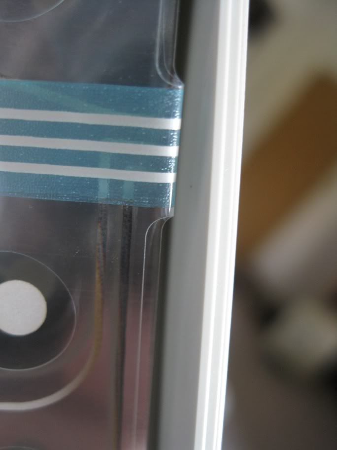

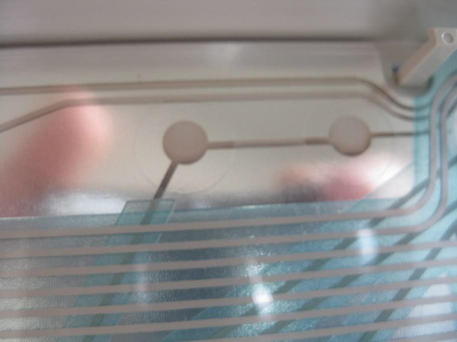

so recently got one for free.  have just disassembled it for cleaning and it looks like some traces on the matrix are burnt.  dont have much exp in this.  but ive heard with the right pen i could redraw them.  the keyboards work but some keys didnt.  mainly  t y backspace [ and ] are the ones i can remember.  thanks in adv for replies

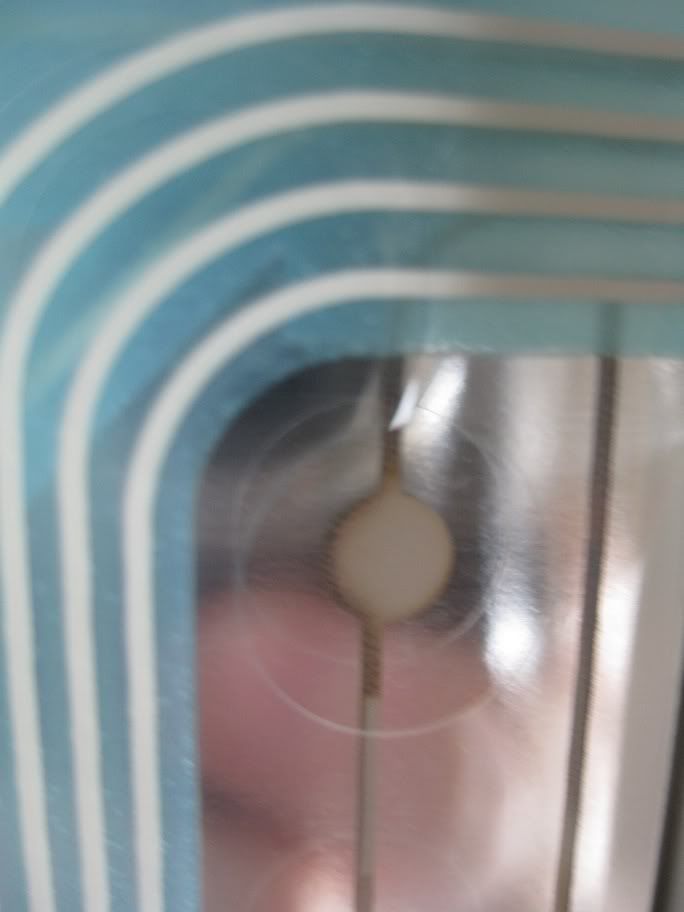

They aren't bunt. I don't know the cause of this discoloration (because I don't know what these traces are made of) but often such brown traces still work.
Connect this board and check (by tapping the membranes with your finger) which keys don't work and whether it's correlated with discoloration of traces. The cause of this problem might as well be bad connection between the membranes and controller PCB.

Traces going brown doesn't mean much within of itself. If you have dead keys, you'd want to get some sort of multimeter and test the traces on which the keys are on for failure points.

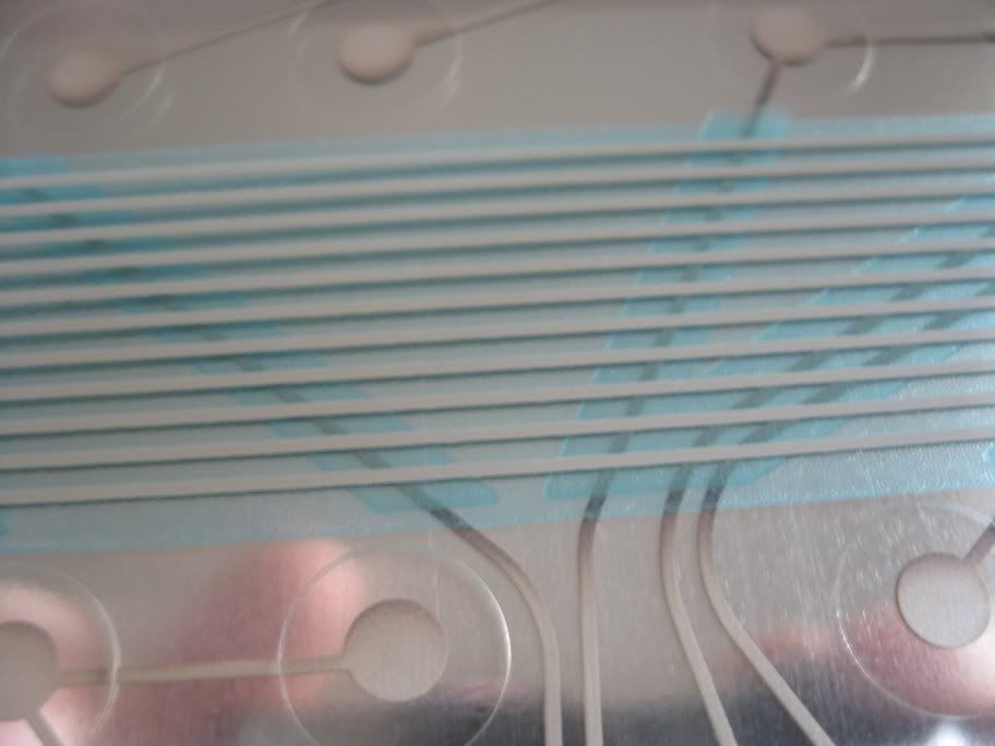

will do that when i get  a MM.  also teh pix dont show it but one of the traces appears to be flaking off.
anyone know of the pen i can redraw if it is as simple as that and not a capacitor problem or the pcb isnt seated correctly.  and sadly cuz im a fool have reassembled the keyboard.  so ima have to take it apart again.

If any trace is really missing, broken you should be able to repair them with a silver paint pen.
Is relatively easy to find in the car's accessory stores as, usually, is meant to repair the heater on the back window of  cars (sorry but I don't know exactly how do you call both of them)

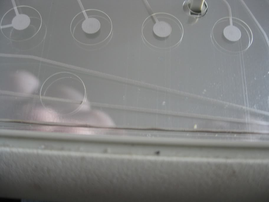

Going to go full necro here.  Over 3 years later pulling a Lazarus.  It'ts time to get this bad boy working.   I have verified that the only keys that are not working are:  T y [ ] backspace and on the numpad 4 5 6.  They all apear to be on the same trace.  Is this still likely a controller capacitor issue or maybe a bad trace somewhere.  (note that i did reseat the controller with no change).

Do you have a multimeter? Select 'ohms' and test between two different points that should be connected.

feel dumb now.  Took all of 5 minutes to find a break in the trace.  Off to a auto body place or somewhere to find a silver pen.

Reparing it is easier than it seems, but do practice forming a trace on a piece of paper first.
Painted traces are usually too thick,
so you might want to "paint" by grabing a tiny droplet with a needle, box cutter tip, or tiny flat-head screwdriver.
