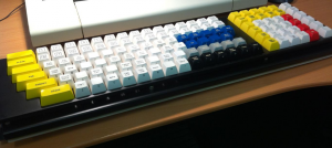

Xavierblak got in touch with me a few weeks ago after acquiring a triplet of rather interesting keyboards. Fast forward to today, and here is one sitting on my desk.
76472-0
His thread has lots of information and far nicer photos than my iPotato managed to produce; check it out. In short, it's a linear, capacitive, foil-and-foam keyboard unit out of a B52 Stratofortress. The keys are engraved and filled sphericals; not as much depth and weight as the beautiful Honeywell and IBM sphericals, but still nice keys. Any shortcomings are made up by the terrific legends; “WPN DELIV”, “RDR JAM”. Oddly enough there's an “MSN” keycap too...

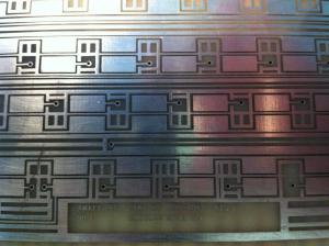

The “pad card” is quite interesting. The bottom side is simply a hashed ground fill (pretty!), with some hookups for the columns, no direct part played in the capacitive sensing:
76466-1
The top side of the pad card is where the interesting stuff happens:
76468-2
The funny bits (looking a bit like Chinese characters) inbetween the key pads is simply more ground fill. The capacitive part is formed by the over-under pairing of the two rectangular pads. The pads with vias connected to them are columns; the other side are rows.
This is quite a different system from what IBM used; they used capacitive coupling through no less than three capacitors formed by pads and the flyplate. The system Amkey used here I can see is more prone to stray capacitance (probably why they used a hashed ground fill rather than a solid ground plane, to mitigate some of that), but is resistant to electrical inteference without having to use the massive heavy bottom plates fitted to the Beamsprings and Model Fs.
There are two connectors; one 32-position pin header across the top (columns), and one 16-position pin header down the left-hand-side (rows). That sounds like a rather fearsome amount of rows and columns until you starting buzzing it out and realise both connectors have interleaved ground pins. Every even-numbered pin is ground. This is more noise shielding (the keyboard is quite open in construction, you can see why it might be necessary).

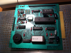

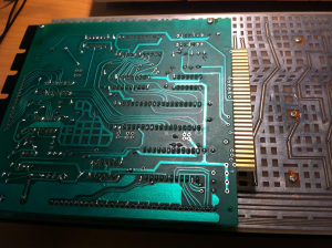

Let's take a look at the controller (don't you love that curvy hand-routing; one day Kicad, one day...):
76470-3
Here we start to get an idea of how they're doing the sensing. The big AMD chip is some sort of micro; the chip at the bottom with the label an EEPROM. At the top right there is an 74154 to break out the 16 connections for the columns, so the micro only needs to drive four lines. The interesting stuff is over on the left, by the 16-pin row connector.
Here we have an MC14051 analogue multiplexer, to break down the 8 row sense lines into a single output. This is fed to the MC1357. What's that you ask?! Why, it's an FM amplifier! Something you would normally find inside an FM radio or a TV. Why is it here? Well, bearing in mind RF/radio is not exactly my area of expertise, the MC1357 is a certain type of FM chip. It's got a quadrature detector in it. This gives us a clue. Quadrature detectors are designed to carefully follow oscillating signals and pick out when they start deviating from a certain frequency. They are tuned to a certain frequency (the knob on your radio!), and then feed the signal through a capacitor which shifts the phase and allows the detector to measure how far the signal deviates from the centre frequency. Sound useful? In this implementation, the capacitors within the keyboard are used as part of the circuit, varying the centre frequency and with the use of a little comparator (8-pin LM393 at the top left) to scale the signal back to TTL we can read the pressed keys.
It's an inventive use of a part designed for something completely different, but would be highly effective and reliable. On the negative side, you could see you'd need to hit each column with a few square wave cycles before you'd be able to read the result, so it's not quite as fast as the IBM dV/dT method that I pinched for my controllers.

The other two controllers for xavierblak will have to wait a few days while parts I ordered arrive. I didn't manage to time the arrival of these very well with the arrival of the PCBs, sorry (I also ran out of 2x3 right-angle header pins, so no expansion port on this first controller just yet). On the plus side xavierblak won't have to put up with horrible colour-clash green header pins. I think the white/black/silver colourscheme will look quite nice...
79076-0
79078-1
Oh this is my keyboard-feet solution:
79080-2
A bit slidey but I ran out of more rubber feet. More of them arriving in a few days as well.

Can you post any pics of the bottom of the keys, or whatever it is that contacts or gets near the PCB that triggers a key stroke?
Re: Amkey capacitive keyboard controller
« Reply #33 on: Thu, 09 October 2014, 12:55:30 »
Like any capacitive keyboard, it is a "non-contact" design. You could set the threshold to actuate at the very bottom of the keystroke, but basically what you get is an increase in capacitance as you press the key. Once it gets past the threshold you set then the controller decides a keypress has occurred.
more info in this post:
http://geekhack.org/index.php?topic=62553.msg1464586#msg1464586
Does it work? Kind of! I have a bunch of faulty connections (I tried just blobbing solder in there on the controller without stripping the wire; it often works with that thin Kynar insulation as it just burns off, but not 100% in this case), but nevertheless I was able to set a manual threshold voltage on the controller and press keys and get responses :D It's missing some columns and one or two rows, but nevertheless I can damn near use the thing.
Interestingly, changing the threshold voltage actually changes the “activation point” of the linear keys. I will have to be careful with my so-called debounce filter (there's nothing really bouncing here of course), as without the mechanical hysteresis of the IBM beam/buckling spring there's the potential to get some rapid toggling of state if the key is held half-down.

Here are the other two controllers going in the post on Monday:
79363-0
79365-1
