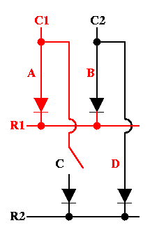

Yes, if you leave a diode unconnected the key will stop working.
The reason is that current has to flow through the diode to reach the controller, You can see this in figure 18& 19 on this page:
http://www.dribin.org/dave/keyboard/one_html/
