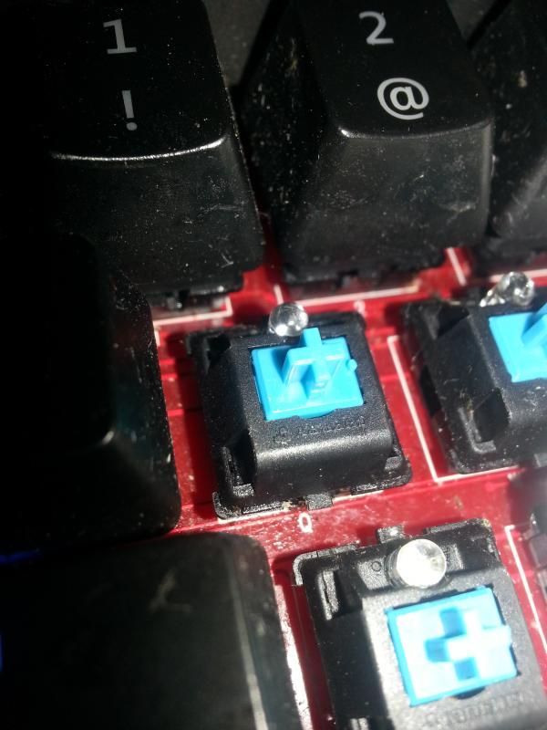

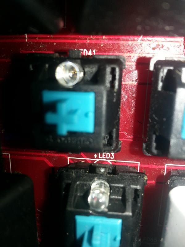

« Reply #8 on: Sat, 22 November 2014, 18:13:53 »
Sorry for the late response, but I finally snapped pictures of the key and a close-up of the PCB (don't mind the dirty key caps, please).

Re: My KBT RACE is acting funky
« Reply #10 on: Thu, 27 November 2014, 17:23:24 »
Pictures of the back of the PCB are what is necessary. That is where the funkiness would likely happen.
