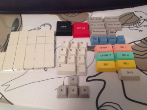

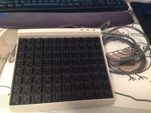

I found a beautiful Access-IS AKENOVL 8x10 matrix board at work with plate mounted blacks and some cool trading keys, hanging out in the discarded tech area at my soul-sucking big bank office.  Truly a case of one man's trash is another man's treasure, as I had been wanting a programmable matrix keyboard for a while.  Gave it a nice vacuum and alcohol cleaning when I got home and it's good as new, except for the fact that I can't get it to work.
I plugged it in and windows recognized it and the three LEDs lit up.  I installed the SoftProg software found here and programmed a few keys and downloaded my settings to the keyboard.  I tried some of the keys I set (very basic, just letters and a copy command) and got nothing.  I unplugged/replugged as mfr site suggests and still got nothing.
I tore it down since it is a pretty straightforward construction and everything looked fine, no potential problem spots stood out like spills or anything like that.  Put it back together, tried a few different keyboard IDs USB:MK2 AKENOVL USB 10x8 and USB:MK2 AKENOVL CUSTOM HID (which mfr says requires special drivers - is there a way to check if mine for some reason is Custom HID?) and still nada.

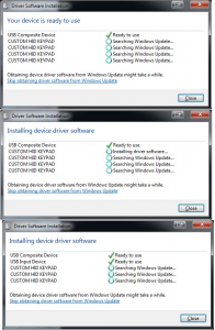

Below are some screenshots of the unit, keycaps/blanks I harvested, and installation screens.  Windows tried installing five different drivers for it, USB Composite Device, and four Custom HID Keypads.  The four Custom HID Keypad drivers eventually turned into USB Input Devices and "successfully" installed as seen in the below screenshots.

Yeah bankers could care less about tech which is why I ended up with this little guy.  I attached a pic of the model, it is definitely AKENOVL.  I tried the other two 8x10 configs (both AKEOCUL) and got either "This parameter is incorrect" or "The handle is invalid" errors, both of which took a few hundred times pressing OK to clear, which moved the progress bar along, but then nothing happened.  Ugh.
