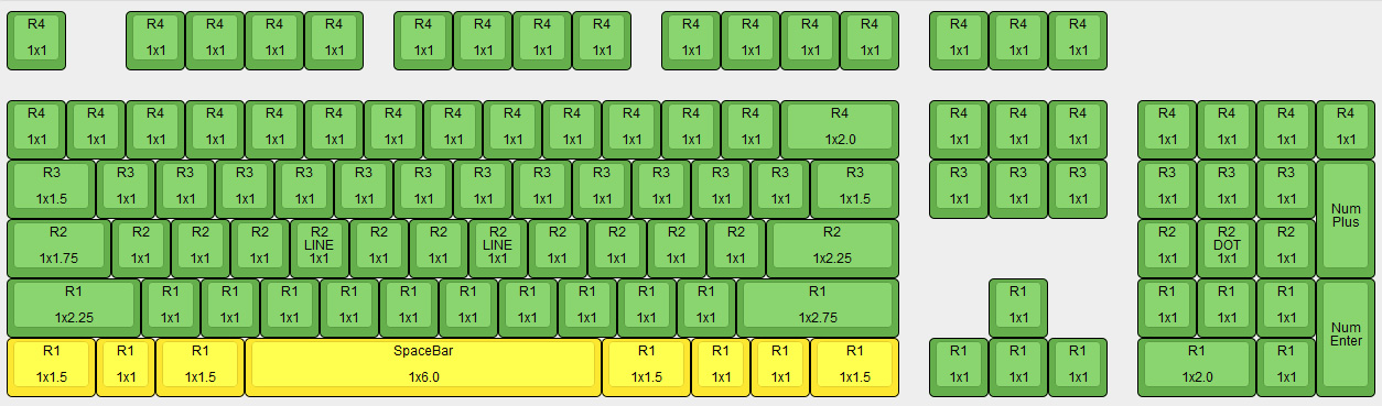

Keyboard size
My Full size Das is actually too large and I could use some more space for my mouse when playing games. The keypad is must-have when working on Excel for instance but not so useful otherwise.
I have watched some possible layouts and need a proper ESC key, F keys and arrow plus some keys on the right part (DEL, END, PRT SC).
Following keys are rather useless for me but come with the standard layout: SCR LCK, PAUSE, HOME, PGE UP, PGE DWN.
Maybe they have some specific utility that I am not aware of. I would go for this kind of layout and size.
Is it difficult to get the LEDs under the keys? What do I need to plan to get them properly working? Is there any influence on the switches, wiring, firmware? It is not clear to me how this works.
For the space bar size, I think I will go with a 6 units bar to get the bigger alt and control keys left and right that I use a lot.
Is there a more 'standard' size for the space bar (6 or 6.25)? I am not sure what is more common to avoid problems finding custom key sets.
Well I guess that's pretty much it for the size itself. I just need to learn how the LEDs would work and what it implies.

I like the bottom row you've chosen.  (Realforce 87U style).  6x spacebars aren't particularly common in MX but they can definitely be found.  Cherry made an offset version and SP sells a few center stem versions.  6.25 are the most common, and 7x are easy to find in Tsangan kits.

I would go with a more standard bottom row simply because of keycap choices. The ONLY set I know with a 6x spacebar is the MAX universal set.
Yes, SP do make 6x spacebars, but none of the full sets they sell includes one, and the separate ones they sell are avalailable in very limited options (DCS and DSA profiles only, DCS is only available in one colour and DSA in only six colours, none for SA profile).
So I would highly recommend 6.25x or 7x size spacebar as they're the most common and you can fit almost any set you like. Keycaps can really change the feel of the board, so if you use a standard layout you can try different profiles, materials and colours to find a set that matches your custom board perfectly. After all, you're putting all the effort into making it, why settle for one set of keycaps or lock yourself out of later options.
Hey I have been realizing this today as well. Could not find good PBT keycaps with 6.00 space bar. I will go for a 6.25 layout I think, for the sake of compatibility.
I am pretty excited about getting my hands on the hardware and getting into coding the firmware for this.

I have been looking for ideas for my case (material, mouting parts etc.) and I realized I could go for an extended Tenkeyless as well (similar to what the CM Quickifre TK does).
You can switch between function keys / arrows and keypad using NumLock, pretty smart. I hope they dont have a patent on this.  :p
Click here to say what I mean
Quickfire TK
Keycaps would not be a problem since I would buy a blank 104 set anyway. What now bothers me is to display when NumLock is active or not (LED?).
I dont really know how I could include it in the layout in a smart way. I would go for plate mounted switches on a metal plate and keep it minimalist (no case).
A single LED popping out of the metal plate would look pretty poor though, I have not found a good solution yet.
If you have ideas or know a keyboard that use such a layout, just tell me!   :D

Hey guys,
So I have been looking for ideas for my new extended layout but there is still a problem that I need to solve.
I would add a LED to show if NumLock is active or not but two questions:
- How complicated does the hand-wiring get if I want to add one or two LEDs at the top right corner?
- Do you have any example of good-looking plate mounted keyboards without a full case that use LEDs?
