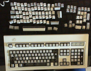

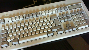

A few weeks ago I had the luck to find an announcement for a 1990 IBM-made Model M in italian layout in seemingly excellent conditions, basically everything I was looking for. And so I bought it.
It arrived the other day:
179136-0
Detachable coiled cable, two parts keycaps, grey secondary lettering on the numpad, and the left Alt key has green lettering, while the right Alt Gr is black.
Although not excessively dirty, it was clear it needed a good cleaning. I started with the caps, and noticed that the undercaps corresponding to the F, J, and 5 (numpad) were white instead of grey, a detail I enjoyed a lot.
179138-1
The spacebar is wire-stabilized, while all the others use shaft stabilizers.
I didn't want to spend for a 5.5mm nut driver, but the bic and lighter did the trick anyway. Once inside I found dust wool on the base, and that two plastic rivers broke off. I decided I won't do a bolts and nuts mod yet: if it's not broken (too much), don't fix it, am I right?

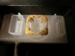

Many hours and q-tips later the barrel plate was clean again, at which point I noticed that the insides of the barrels, especially those of the most used keys, were coated with an extremely fine white powder; I blew inside the barrels with a straw, and it helped, but wasn't enough, so I dusted them with more (dry) q-tips and it removed most of the dust, but in the corners the dust was still there.
I then used a cleaned keycap to see if I felt any difference, and the results worried me deeply:
F keys and other less used barrels were noticeably smoother than the main letters regardless of the cleanup I did up to that point.
Now, considering I don't want to separate the barrel plate from the metal plate, I have two options:
  • use more q-tips with a cleaning agent
  • lubricate the barrels
Both options have risks: both the cleaning agent and the lubricant might be corrosive for the plastic, as I read here on geekhack and other forums, and I don't know what can be safe to use. Are the barrels just worn out or an effective cleaning might solve this problem? What do you guys suggest?

Bolt mod and wash the barrel plate in soap / water (but that is just me).

Never lubricate a buckling spring keyboard.  There are people who do and probably swear by it but it isn't needed.
The rough keys might just smooth out with a little use.

I'd really like to avoid doing a bolt mod for a few reasons: first and foremost because I fear of damaging it, since I don't have any experience in this kind of work and I neither have access to precision tools like a vertical drill press to help me. Secondly, as I already stated, I really hate the idea of having to damage it further first in order to fix it.
Lastly, I wanted to try every non-destructive option first.
If lubrication isn't advised, the only option is a deeper, more scrupulous cleaning of the barrels' insides.
What about lubricating the plastic stems on the larger keys.  The ones that go into empty holes, not the ones that press the springs.  Would some superlube help off-center key presses?  (sorry to thread jack, just got my first M as well and I'm in the process of cleaning)

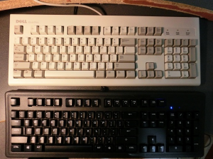

I was rounding up the cleaned caps and I the following: caps have been molded differently.
EDIT: I've realized I miscounted the caps circled in purple: they're 64
179149-0
When I removed them I didn't notice this difference, so I really have no idea what keys they were attached to, and I couldn't find anything on the internet regarding this peculiarity either.
Anyone knows anything about why such differences and their placement in the keyboard?

Sloppy production.  The corners are supposed to be open.  If the end is covering a hollow space then I doubt much is different, but a filled corner maybe that would dampen spring vibration thru the key a bit?
They're all interchangeable as they are.

Honestly I thought about production defects, especially for those circled in green and blue, but those circled in red are so well made it made me think they were produced like that on purpose, more for spring weighting rather than vibration dampening. Still, quality's exceptional.
