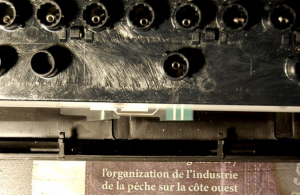

Obviously this board must now be bolt-modded—I'm looking forward to that, as it'll be my first. But I've noticed something odd: There's a bit of membrane protruding below the left side of the spacebar:
103285-0
I'm guessing this is why the spacebar doesn't register. Has anyone seen this happen? Is it likely this KB will need an entire new membrane, or is it fixable? I just thought I'd ask before I open the assembly and start fooling around. Thanks, A.

That looks like the traces for the mouse buttons used with the trackpoint setup.

That's good to hear... Well, we'll see what's going on as soon as I have time to open 'er up.
