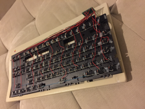

Seeing all the cool projects being done here made me want to experiment. I figured I'd start small by converting my AEK II to USB using TMK firmware and also cut it down to a TKL board. Nothing fancy. I did remove the dampening bands from the white alps switches.
I'm planning on dying some of the keys, but otherwise it was a fun project; it'll make a nice office board. There is so much good information here on GH, thanks all for their contribution, especially hasu.

Very nice, how was it getting the case hacked down?

Cutting down the case wasn't that bad. Just had to go slow and measure often. Still have some cleaning up of the case to do.

oooo Very cool. Reminds me of the AT101W that was cut down to a TKL. How'd you get the case back together? Epoxy?

Same stuff or pro weld works like magic. Very forgiving.

So what made you choose TMK for a handwire over soarer's controller? I've only used the latter.

very cool. forgive the n00b question - how did you convert to a smaller pcb? i'm assuming you de-soldered and re-soldered the switches?
No particular reason. Just thought tmk was easy enough to figure out with all the information available on GH and DT.
Yea, de-solder and then hand wire the matrix to a teensy.

« Reply #11 on: Mon, 08 June 2015, 22:43:13 »
Ah. That's why I picked soarers controller. It seemed all I needed to do was enter in the keys and matrix. TMK looked more involved.
There isn't a PCB anymore. He desoldered them and tossed the PCB. There are wires directly connected to the switches and the teensy. Looks like with added diodes for NKRO. Personally I'm fine with the iMate for these, they seem to have more than 2KRO as it is.
