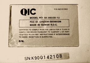

"It's a QIC, model SK-8802B-1U", she replied. "It's beige and clicky." Well, we all know beige and clicky are good, but I'd never heard of QIC. I looked online, but couldn't find a single reference to QIC or the model number.

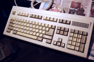

When the keyboards arrived, I saw she'd been correct about the 2nd one:
109758-0
...but it was covered with greasy grime, as though it'd been used in a machine shop or garage:
109756-1
When I opened it, I found it was actually a Silitek SK-8802B-1, which they'd apparently made for for an obscure OEM. I was pleased to see it had vintage Cherry MX Blue switches, and it tested perfectly, so it was up to me to make it useful again.

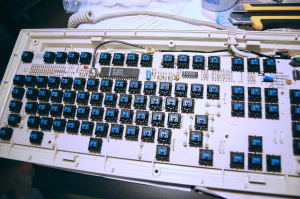

I put it away for a while, then took it out again yesterday. The inside was even grimier than the outside. It'd obviously been around a smoker, for greasy cigarette residue was congealed around every component on the PCB (I decided to spare you a photo of that. It boggles my mind that people put this sticky brown gunk inside their lungs... I don't know about you, but seeing one board like this would make me a non-smoker for life!)
I slipped off the key buttons—Cherrys buttons are refreshingly easy to remove, aren't they?—and soaked them in warm water and liquid laundry soap for half an hour, stirring every 10 minutes (complete instructions included for noobs, which I was not too long ago).
Meanwhile, I got busy with some alcohol, Q-Tips and small brushes, and an hour later:
109760-2

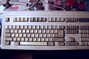

I washed the case with dish soap. I sprayed a few stubborn spots with Windex, gave it a minute to work, then wiped them clean with a paper towel. (Paper towels and rags are better than Kleenex or TP, which are too soft.) I let the key buttons dry overnight, then reassembled:
109762-3
There are pen marks on a few keys, but they don't bother me.
