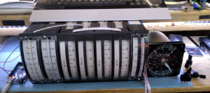

115015-1115017-2

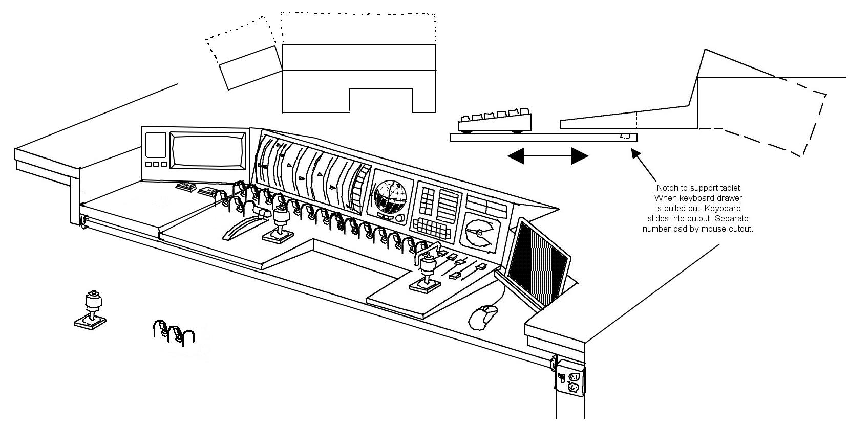

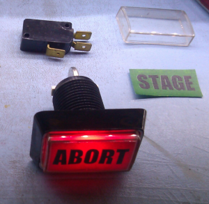

So... back to topic. As you can see above, I have some exceptionally nice hardware for my simpit. It'll be built right into my desk. Fortunate that I built my desk for a triple monitor setup, back when CRTs were the norm! SOOOO much extra space now! ;D Anyway, I'll have meters that read things like Liquid Fuel, Oxidizer, Electric Charge, Xenon Gas (for ion engines), G-Forces, Atmospheric Pressure (for launch and landing), etc. The round meter will be to display vertical velocity, aka. the "Am I gunna die meter".  :p You can see some of my toggle switches in the image as well. In addition to those very nice meters, I'll have these pair of large mechanical switches. They use a cherry momentary switch mounted to the base (not an MX). As you can see, they are backlit, and will serve as my Staging and Abort buttons. You can't go to space without at least one Big Red Button™! Bonus points, cause I also have a Big Green Button™! There will also be covered safety toggles that arm and disarm these buttons. The light will come on when armed. The Abort button activates the launch escape system, while the staging button advances you through your stages (drop an empty tank, light the next rocket, etc). They use very nice clicky switches! In addition to toggles and meters and such, there will be 7-segment LED displays that read out details such as Altitude, Radar Altimeter, Apoapsis (highest point of an orbit), Periapsis (lowest point), Inclination (angle of your orbit), and so on. I will also be using a number of annunciator indicators (dummy lights), and hope to integrate some other technologies in as well. One of the pieces of equipment I acquired is a 3-axis FDAI (Flight Director-Attitude Indicator). Kerbal players refer to it as the "navball" while most people in aviation would call it the "artificial horizon". Both the Apollo Command Module and LEM, and the pre-glass cockpit revisions of the Space Shuttle both had similar FDAI devices, and my FDAI stands as my most valued element of my simpit. I'm currently building a controller for it. I have to generate ten 400 Hz sine waves of varying amplitude and polarity to control the thing!

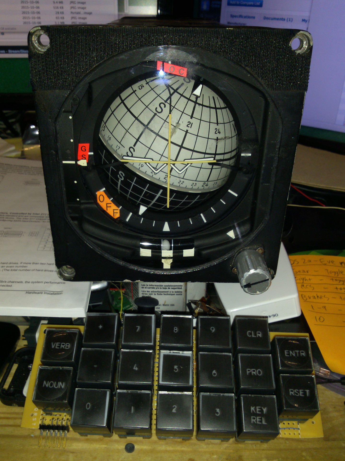

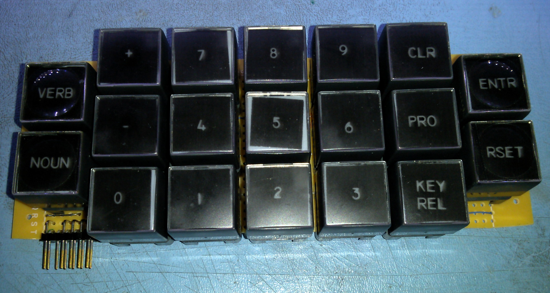

This is the keypad I built.

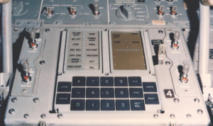

Left is my Keypad, right is an actual DSKY.
115023-4115032-5

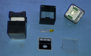

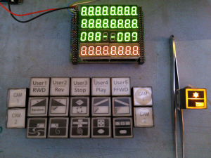

It's not a perfect replica, by any means, and my labels are just awful. I need to replace my printer, cause it streaks and blurs edges, so when I cut a few wrong, I said, "meh, I'll get the final ones done at a print shop". The keys are very firm, linear switches.You don't type on these, you push these! The switches are EAO 99-455B. Mouser carries them for $6.95 EACH! They refer to the switching as a "Low-level element", but I'm uncertain what that actually means. It does say it is gold plated anyway. I used 19 switches... and no I didn't pay Mouser those prices. I had an old video effects switcher that had 86 of those switches, and 127 smaller ones (about 2/3 the size of these). They ARE illuminated too, and the LED is even socketed! You can just remove the LED and replace it with any color you like. You can even drop a bi-directional bi-color LED in to get three colors (+ red, - green, and yellow with AC current, for example). Very nice little switch! Fully relegendable. Pics show the switch disassembled, and the original effects labels I removed, plus one of them lit up. You can see some of the LED 7-segment displays i'll be using to complete the look of my Kerbalized DSKY.
115025-6115027-7

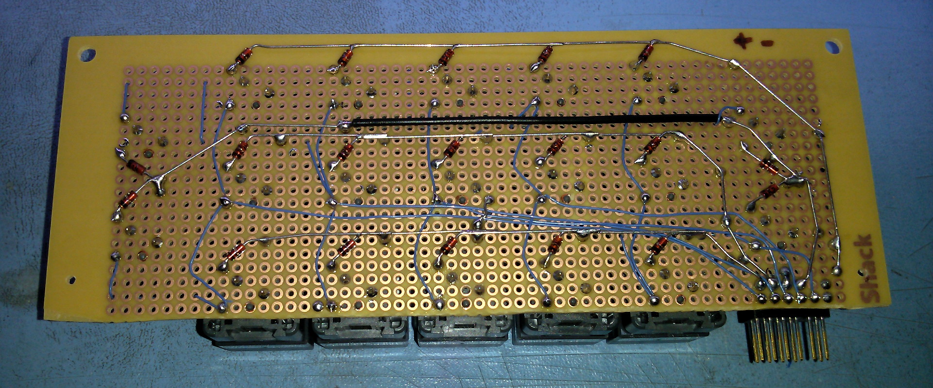

These switches are really nice, because if you just slightly drill out the holes that correspond to the alignment posts, then these nicely fit 0.1 inch grid spacing pre-drilled proto board! You can't do that with an MX switch! I fit the switches to the proto board and then wired them into a 4x5 matrix, with diodes. I actually used some 33 volt zener diodes instead of regular switching diodes... But a 5 volt scan will NEVER exceed 33 volts, thus these zeners are effectively switching diodes at these voltages... I also have over 9000 of them on a reel... 19 down!  :p
I used point to point wiring, relying on the diode leads to form the rows, and wire wrap wire to form the columns. The rows are made up of the three obvious rows, plus all 4 side keys, as a single row. Each 2 side keys is tied to the outer two most columns. The center column only has 3 rows. The 4 rows, and 5 columns are brought out to a right angle pin header. 2 additional pins will provide backlight power. Have not decided if I will run a 5 or a 12 volt bus to it, so I've not wired the LEDs yet. It'll just be a bunch of resistors, wired much like the diodes are on the rows. I'll use thicker wire than the 30 gauge wire wrap wire to join the rows and to wire the common of the LEDs. I had considered individually addressed LEDs, but I'm just not seeing much need for it, at least not with the hardware I have on hand. My DSKY will be used for "meta" game functions... Save, Load, Time Warp, Physics Warp, Stop Warp, etc... Besides, I need things to display on the annunciator grid. If I had buttons doing all the work, I'd render the grid rather empty! It'll likely have indicators for SAS (Stability Assist System), RCS (Reaction Control System), Lights, Gear, Brakes, Chutes, Warp (green for regular Time Warp, red for Physics Warp), Prograde, Retrograde, Normal, Radial, Target, Node, and Anti (to indicate Anti + Radial, Normal, Target, and Node). That also should keep me in the 2x7 grid that the original DSKY typically used.
