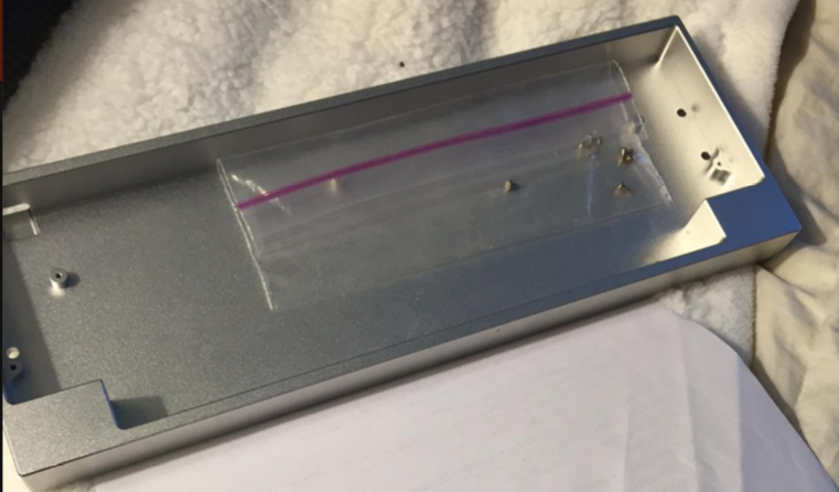

I honestly think a standoff maybe 2mm high would be sufficient for each screw hole like the Duck Viper for instance.
Photo taken from rockhawksam's classified thread
