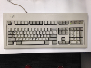

So, here I found this old girl lying forlornly on the side of the road.
110148-0
Looking quite dirty, missing a few keycaps and had her cable cut right off at the sdl connector.

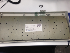

Slid the plate assy out to inspect how many of the plastic rivets have broken
110474-2

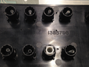

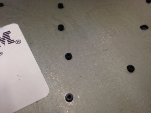

There were a number of rivets broken, but it wasn't until I was cleaning around the barrel plate and the back that more decided to jump off: time for a bolt mod.  :thumb:

In researching the bolt mod, I also came across SpaceGhost's comments within njbair's thread Model M "nutless bold mod (http:// https://geekhack.org/index.php?topic=70410.msg1697379#msg1697379) and I particularly liked the idea of using 'machine' screws instead of a screw and nut.
Unfortunately I didn't take photos of the process I used, but it has been documents many times before by others, and I essentially did the same:

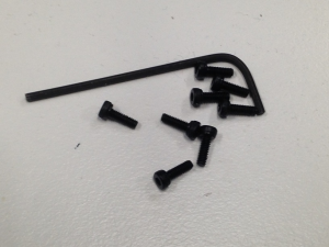

  • Cut off the rivet heads with a sharp blade.  I have an old "wallpaper knife", but a small art knife/stencil knife/etc can be used.  I didn't go as far as removing the posts down to the 'shoulders' on the barrel plate as my reasoning is I wanted to leave as much plastic for the screws to bite into as possible.
  • With the switch plate assembly altogether, drill pilot holes in the posts with a 1mm bit in a pcb drill.
  • Get ahead of myself and now order some screws.
Good old fleabay to the rescue.  Ordered 100 machine screws M2 x 6mm stainless steel hex head finished in black.

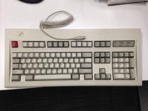

While I wait for the screws to come in from Hong Kong, I have turned my attention to the cut cable.  Here is what remains:
111220-0
I want to try and keep it as close as possible to the original, and ideally would get an original cable from clickykeyboards, but shipping to Australia and the exchange rate puts it over $50aud.  A bit too pricey for me unfortunately.
So, I have spent some time looking around for a beige ps2 curly cord to attach to the plug, which seem to be just as rare as the keyboards themselves.
I eventually found one and now have it in my possession to convert into a copy of the original.

111767-0
I then drilled the holes to a slightly larger diameter and began inserting the screws along the length of the board.
I then worked my way out from the middle of the board towards the long sides doing a final tighten of the screws.
111769-1
A closeup of the finished screws.
111771-2
A closeup of the front of the barrel plate.  A much nicer finish not having anything protuding through, even though it is covered by keys.
111773-3
Although the screw ends aren't flush with the surface (and the photo tends to accentuate that) there is still plenty of hold on the threads and there isn't any movement.

With the left arrow key and a red esc cap (hey, why not! one of the guys threw it in for me so I will put it on now and then to give the old girl a bit of **sparkle**).
111775-4
The final shot with the full set of standard keycaps.
111777-5
I have purchased a straight ps2 extension cable so I'm not straining the 'repro' cable, plugged it in and she worked first go.  Who knows how long it had been sitting unused, so it was a great relief to see the numlock led and feel every key work.
