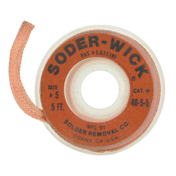

I was able to get the solder to melt but couldn't get them out.
Do you have a solder remover tool? Either solder sucker or a wick is required.

I do have a solder sucker but I'm not sure how good it is. I attempted to use it once the solder was melted :/
That works. I own one but recently I bought a SS-02 which is awesome.
