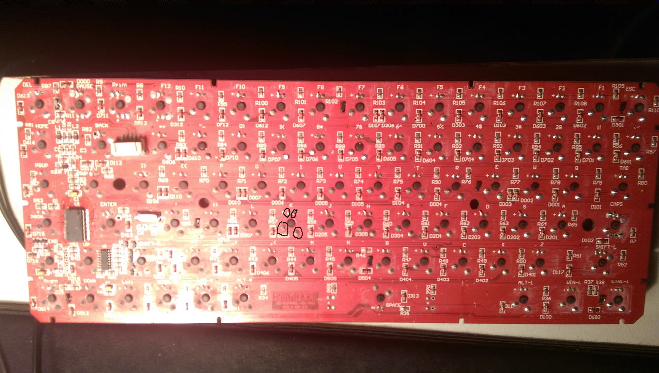

In the meantime I decided to open the case as per instruction in the above video, and here is my result:
https://gyazo.com/366d851103b07be4d7ae394249c3baaf
https://gyazo.com/1a4c303226708d57666e3a4d2a9da37c
Does it look like I have done it correctly?

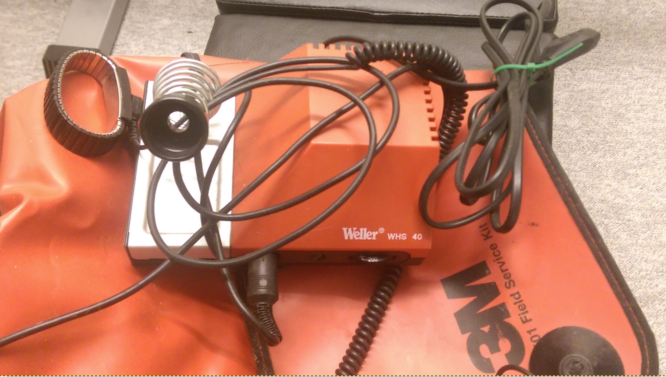

Is my Weller WHS 40 sufficient for soldering? at 350 degrees? Should I get a different one?

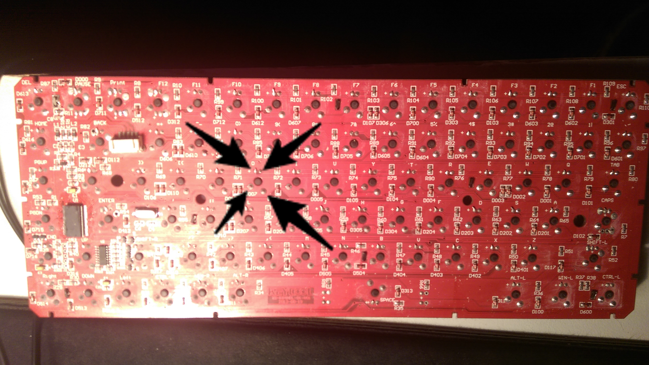

Do I have to desolder the LEDS even if I only intend to change/lubricate springs, stems etc, but let the housing sit?
I understand I have to desolder the two bigger pins, but I also have to desolder the LEDS? I do not care about LEDS for my board, but I understand I have to do it anyway. How should I proceed, and where should I desolder? As far as I can see, these 4 locations are where I have to desolder, but I am not sure exactly when sufficient melting of the metal is actually enough to pull keycap/led out. I marked 4 locations with black to show how I understand the soldering process:
https://gyazo.com/de05a5b6d771f4b3d24e1bb098d66d55

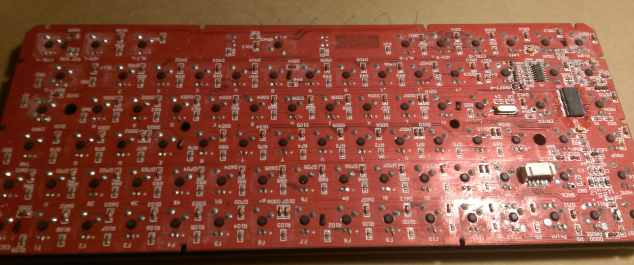

Additional images of my keyboard keycool 84 Kailh red without case:

No, you would have to desolder.

I think my soldering station is set around 350C, but that's highly dependant on your station and whatever solder you are working with.
What matters most is that your solder melts quickly and you aren't staying in one spot too long and causing damage to any parts or the PCB.

I have a WHS-40 and I would rate it 'temperamental' - most of the time it's great but some days the tip doesn't stay hot enough for no apparent reason.  I bought mine modded to have a cooler minimum so that might be affecting it..
You'll probably need full power to desolder switches from the factory as they use slightly different solder but most of the time I use mine on around 5 (less than standard 5) so try starting at 4 and see how you go.  You can see when the solder melts as it looks wet - if it doesn't in a couple of seconds move to another pin (to avoid long heating which can damage the PCB) and turn up the heat :)

Yeah mine doesnt seem to get hot enough, even at 450 degress either. Is there a relatively cheap soldering unit that could work, or maybe my friends which is more industrial but with no temperature control? How important is temperature control?
  • Posts: 4772
Re: How to desolder a keycool 84, change springs?
« Reply #17 on: Fri, 20 May 2016, 14:29:57 »
Is the tip all the way in? I did a switch swap on a Keycool board and it was easy, both other factory soldered boards needed hotter.  Could be from a different batch or even factory though...
I've had my weller years from my time building headphone amps and haven't felt the need to trade up so have no recommendations, I'm sure there's a helpful thread in 'Making Stuff Together!' but I can't find it using my phone.
Generally you want to use the lowest temperature possible to get the job done, if you do use the unknown industrial iron try and keep it quick - too much heat or too long hot means more chance of lifting the solder pads.
