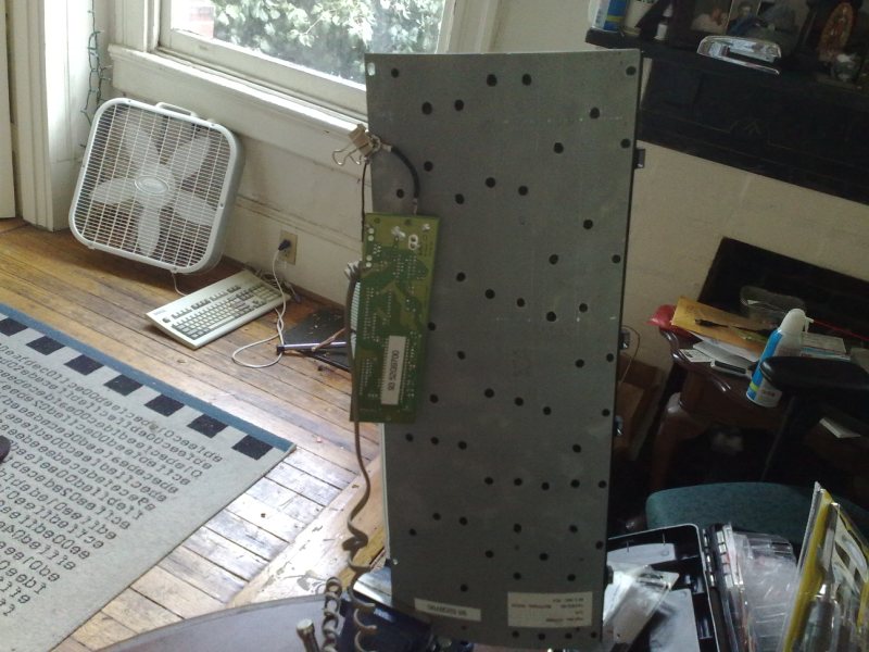

Here's the board before I disemboweled it.  Ironically, this 1993 board was missing very few rivets.

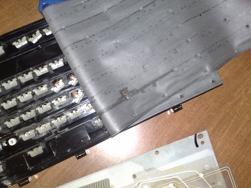

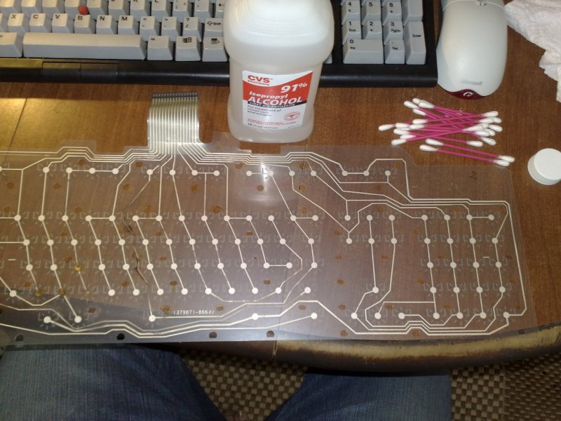

A problem with this board was obvious once I took the membrane out.
Sticky liquid had gotten into the membrane and between the sheets of
the membrane.  You can see the staining of the liquid on the plate and
the membrane.
You can also see the gunk left on the rubber mat under the membrane sheets.

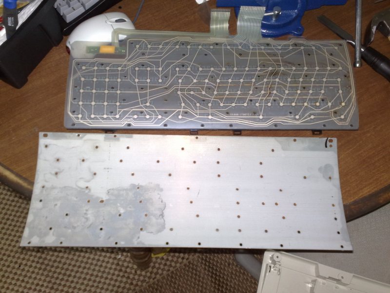

While it wasn't necessary to prove the hypothesis, while I had the
keyboard apart, I cleaned the gunk off the rubber mat and cleaned the
membrane sheets with alcohol.

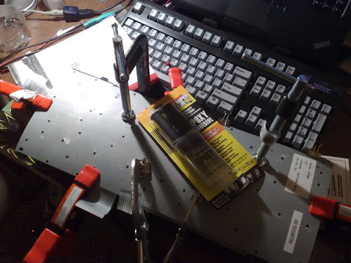

I roughed up the surface of the steel plate above each rivet hole so
that the epoxy would have a bit of surface area which to grip while it
cured.  Then I clamped the parts of the board back together tightly.

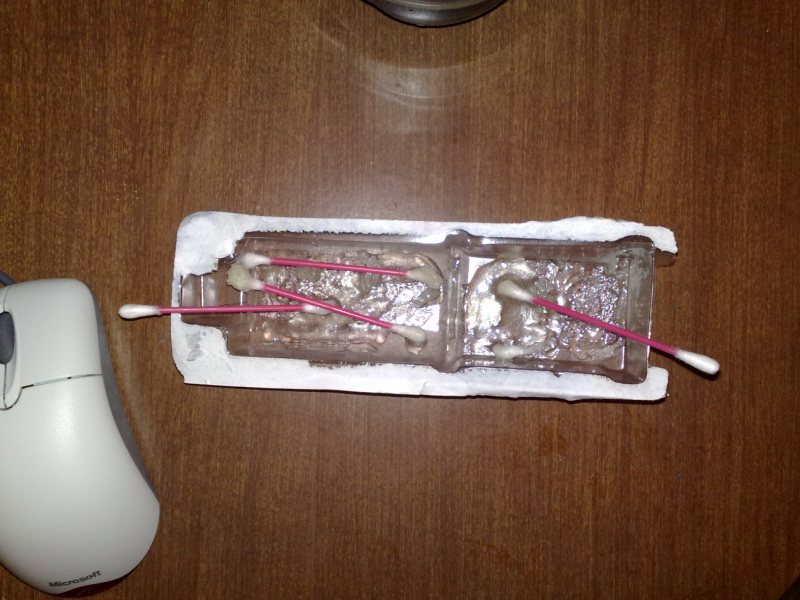

The epoxy looms ominously.

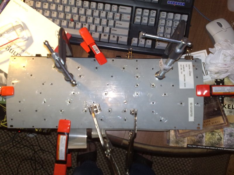

I used a Q-Tip to apply handmixed epoxy to each rivet hole on the
clamped assembly in the places that were clamped most tightly.
Then I allowed the board to dry overnight.  The next day, I moved the
clamps slightly, so that pressure was applied more closely to the
rivet holes that I had not already epoxied; I then applied some more
epoxy over the remaining rivet holes.

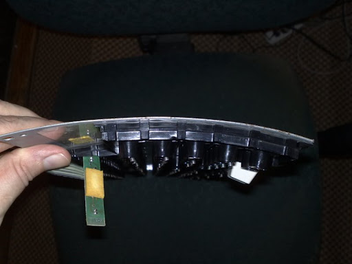

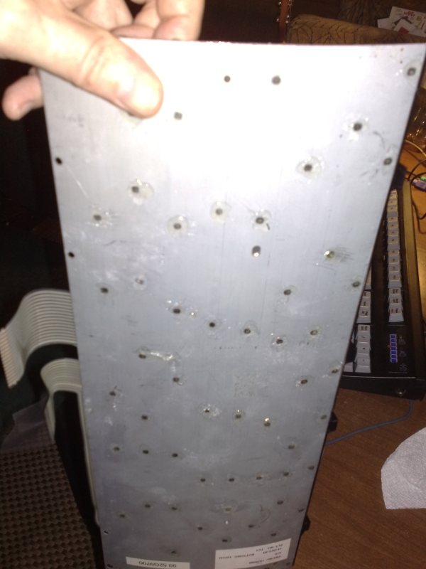

Once all the epoxy set, I was able to handle the keyboard without the
clamps.
It held the weight of the steel plate while I held it up only by
barrels on the frame.  I couldn't pry it apart with my hands even with
a good amount of force.  It looked like the plate became pretty flush
with the frame on all sides. (That flappy bit isn't the frame, it's
the rubber mat.)

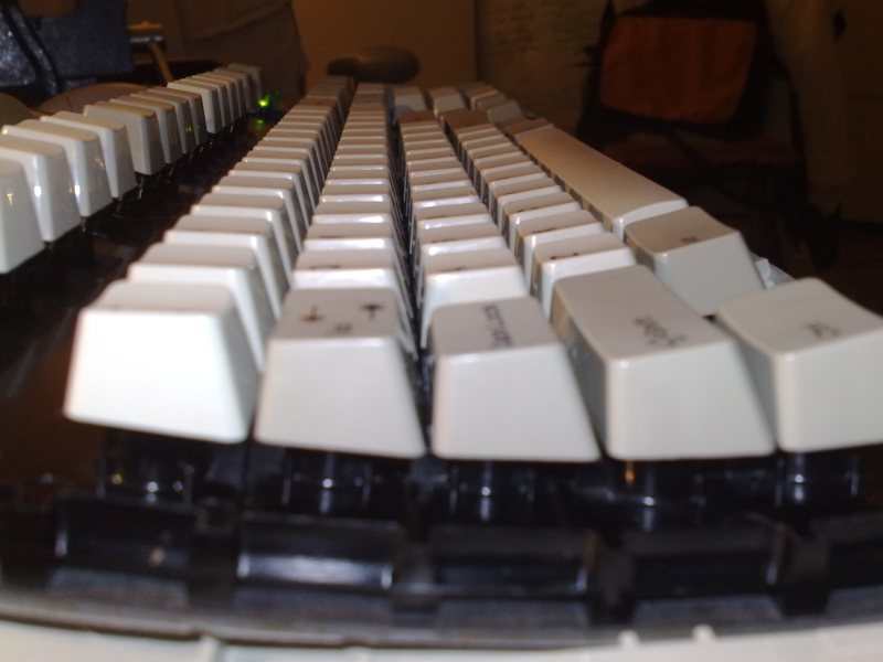

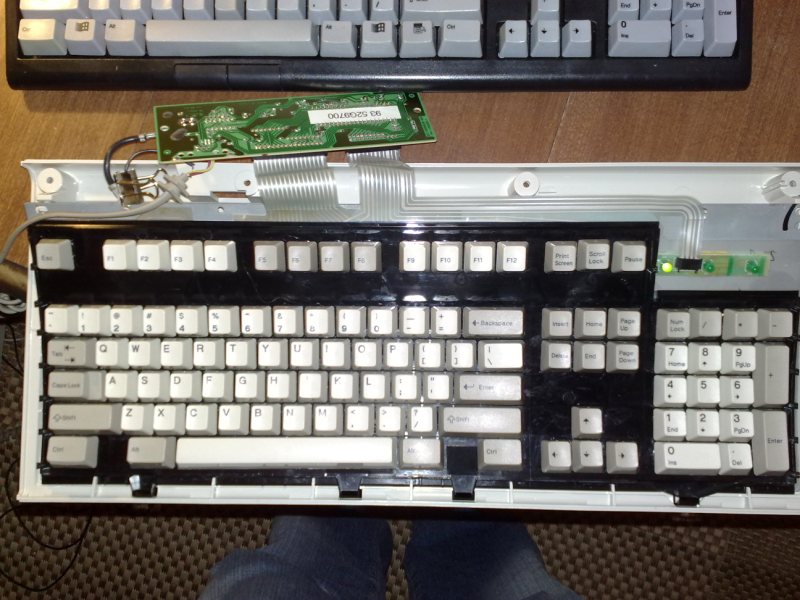

I attached the keys and made sure it worked.
Side angle.
Does the ghetto epoxy riveting mod "work" on a very basic level?  Yes.
Epoxy alone has enough sticking power to hold the steel plate to the
frame in such a way that each of the springs in the each key buckles
satisfactorily.  The epoxy bond between the plate and the frame cannot
be trivially forced apart.  Visually, it seemed that the frame was
satisfactorily flush with the plate.  The keytops were not on
noticeably different planes.
It works, but how about the typing performance?  Slightly below
average.  All the keys that had springs (I stole some from this board
previously) buckled properly after the epoxy riveting.  There were no
lazy keys.  The touch and force required to depress a key was slightly
less than average for an M.  It was spongier than the feel of it
before I deriveted it.  It sounded springier.  But neither the feel
nor the sound was throw-it-away terrible; I would personally feel
comfortable using this totally epoxy-riveted keyboard or giving it to
a friend.  Someone who didn't own 24 other Model Ms would almost
certainly never notice.
