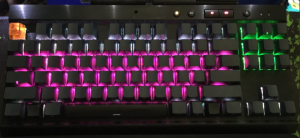

All the keys still work! I wasn't really gentle with it during the transformation so the metal plate took some dings, but nothing is really visible with the caps on. The feel

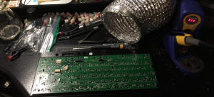

This is about 75% of the way through the desoldering process. I didn't want to admit it would take *adding* solder to suck out the original solder, but in the end it was only necessary for a select few difficult joints.
The biggest scare of the whole re-soldering process was the realization that a pin was bent when I had already soldered all but 3 keys on the first row and some anchors on the bottom on each side. Was able to desolder and replace it. HJJad it been deeper in would have been depressing.

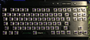

Just snipped all the pcb mount tabs before plate mounting, then lowered the PCB back down and started re-soldering.

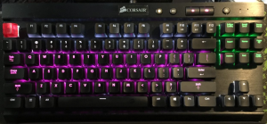

Tried a set meant for a Leopold, the DCS Cherry profile in navy, but the ctrl isn't the proper size.
143228-2
Went back to the original caps and the feel of the Zealios took about an hour to sink in, so great. I'm an MX Brown fan and have been putting up with the reds for about a year. Need to do a GON MX-MINI next and fill out the DCS profile caps and make it like a tank.
